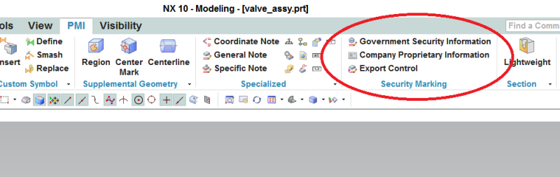

RE: Trade Compliance info embedded in model file
There's an option using PMI to 'mark' your part files with this sort of information.
From the title bar shown in the screenshot, it appears that John is using NX 10. I believe that the same functions are available in NX 8.5 provided that you have a PMI license.

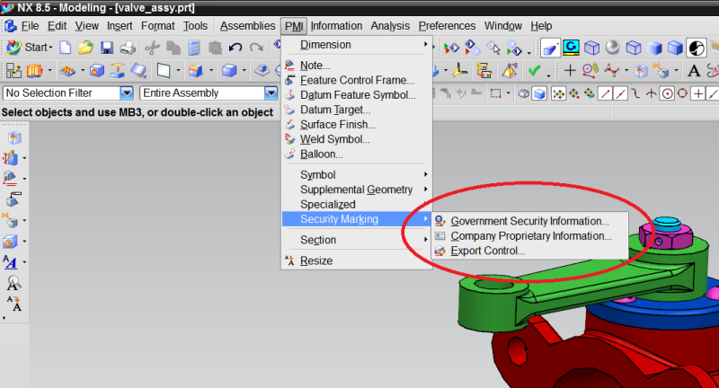

Yes, the same options are available in NX 8.5 (as shown below), as long as you have the PMI module toggled ON.
Alrighty, thanks John and all,
Looks like I need to put in a request for the company to purchase the license for this module.
