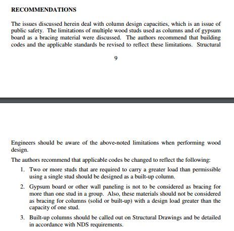

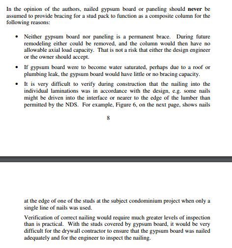

This forensics article adresses a very similar case and disagrees with me: Link. Their argument essentially amounts to built up columns being too structurally important to rely on the quality control and potential impermanence issues associate with using sheathing to brace columns.

However, the concern always is whether the sheathing nailing encompases the outer plies of the built-up column. If they only nail to one ply there is the chance that an outer column ply could buckle away from the column independently within the sheathed wall.

I had assumed that this was an existing condition with some desperation at play. If this is new-build, I definitely advocate using the typical built up column fastening arrangement. Like they say in that article that I posted, QC is probably a nightmare for this.
