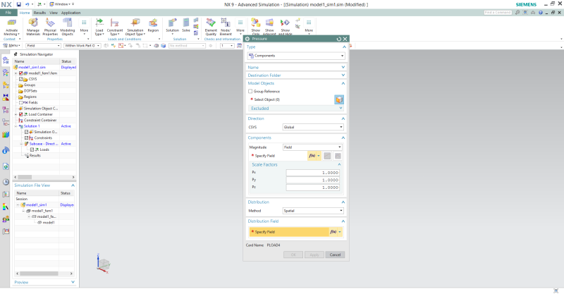

siemens nx 10 pressure dialog box
RE: siemens nx 10 pressure dialog box
In the dialog settings (the gear icon in the top left), be sure the dialog is set to (More), and Hide Collapsed Groups is off.
