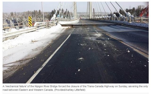

Some engineers in Spain are going to have an interesting few days of review/discussion ahead of them. 2' of movement seems to suggest something was fundamental was missed. It is posted in the failure section too, but it would be interesting to hear some comments from people that design cable stay bridges.
Link to news story: http://www.cbc.ca/news/canada/thunder-bay/nipigon-...
RE: Ontario Cable Stay Bridge Failure
looks cold
thermal movement?
Looks like thermal movement "shortened" the longest cables on the ends, which lifted the (somewhat flexible) ends of the bridge platform up (off of the static bridge end platform).
Did the other end lift up as well?
At this end, there seems to be one platform segment that did not move up. A different support piece spanning a gap between the dirt-supported roadway and the first cable-suspended roadway section?

I believe the other end lifted as well. I agree it seems to be cable shrinkage, but that seems a fundamental consideration if you open the bridge code and look at the degree days where your structure is being built. Much of Canada is very cold in the winter.
Thermal issues seem pretty plausible, especially since the bridge was just built.
The article claims a "gust of wind" but I find that very unlikely.

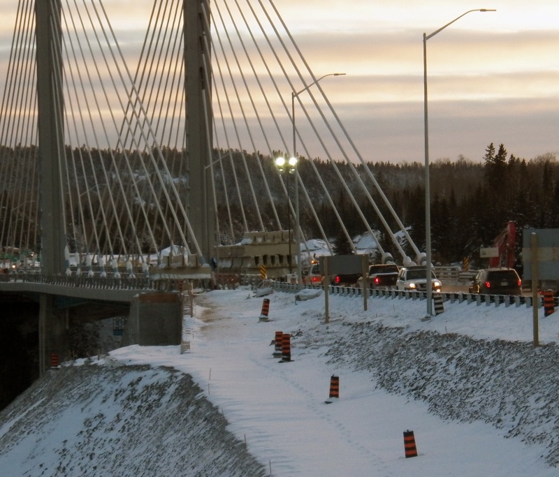

I'm wondering if the fact that the bridge is only half built had anything to do with it. The complete design is three sets of cables and two double lane decks so presumably the middle set are twice as big to hold the central piece and two decks, but they have opened the bridge with only one half built while they demolish the old bridge on the south side.
There must be some sort of differential loading / response here and maybe they didn't analyse the single deck operation quite as much as the whole bridge?
I'm pretty sure it is the "short" side which has jumped up, which tends to show that the uplift force has not been well anchored down.

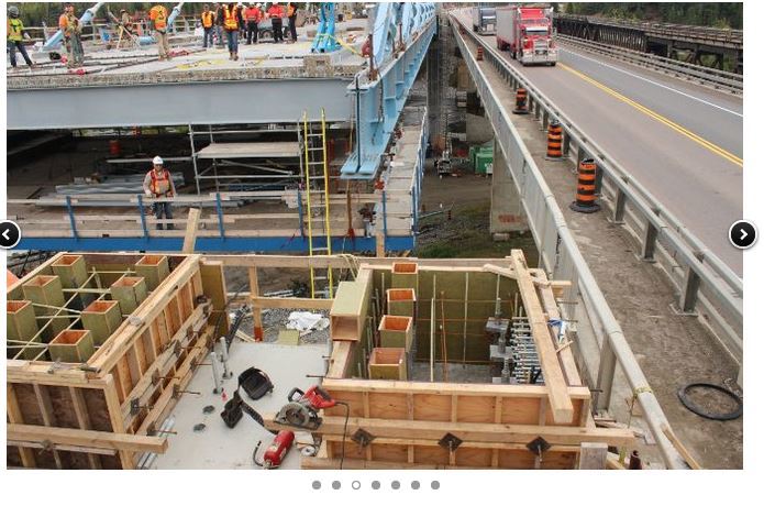

You can see the makings of a significant tie down in the picture below. There are massive anchors protruding into what appears to be the start of a huge cap to deal with the uplift forces bridge buster alluded to. I bet the bolts that failed were the one between the steel girder that would have extended to the caps.

TLHS probably hit on something about this partial build situation. Note the apparent diameter of the cables on the south side. Twice the size of the north side?
