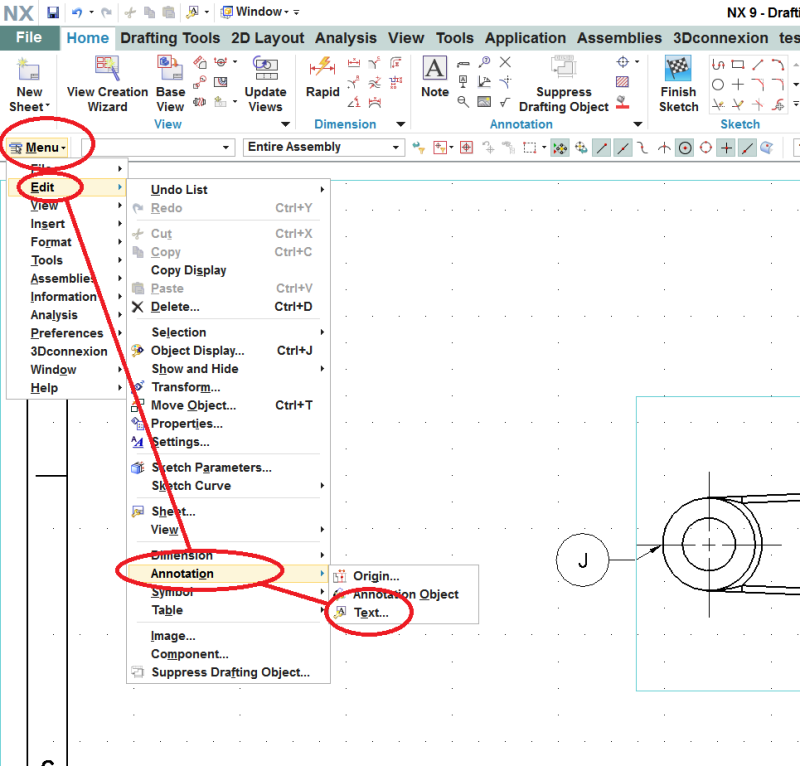

The item you're looking for is still available right where it used to be, only you have to start at the first item in the so-called 'Slection Bar' titled 'Menu', as shown below:
If this is something that you're going to using a lot, you could use Customize to add this function to your Drafting ribbon.
