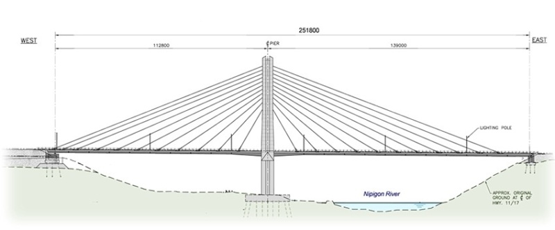

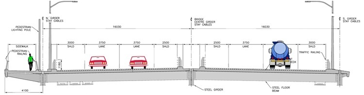

RE: Canadians stranded after bridge splits amid intense cold
Quote:
The new structure is a replacement for the existing two-lane bridge over the Nipigon River. The new bridge is a four-lane, two-span structure with spans of 112.8 meters and 139 meters. - See more at: http://www.hatchmott.com/projects/nipigon-river-br...
The bridge appears to be asymetrical. Is this correct and could this be a contributing factor?
So, why have the comparable cable-stayed bridges in Europe not pulled up their ends? Not as cold? Or a compensator on the longer end cables? Or the "end point" conditions of the two abutments different here, so the ends didn't move up far as actually needed?
I think you'll find that the 'asymmetry' was the result of there being a pedestrian walkway located outboard of the suspension cables on only ONE side of the roadway (you can see this clearly in the video showing the bridge under construction that was at the bottom of the page linked in the first post of this thread).
The bridge is asymmetrical longitudinally and is somewhat asymmetrical (albeit minor) sectionally due to the pedestrian lane.
I was asking about the longitudinal asymmetry. The longest cables seem to attach at different spacing and at different angles.
Interesting question. From the original conceived bridge "photo" and the would be three sets of cables and a divided highway. Apparently what was built was a single two lane roadway, not a divided highway. Looking at the many comments of the public, sounds like a fun time for attorneys and engineers in Canada now.
This link shows the open bridge, a two land bridge, not divided highway. Note the weights on one and to "hold it down"? I guess the design could act like a "teeter-todder" otherwise.
Yes, it appears that the biggest difference, longitudinally, is the distance between the main pylon and the abutments but that portion of the span where the cables are actually attached appears to be very nearly symmetrical with the possible exception of the first two cables on the far Left in Ingenuity's longitudinal diagram, however I'm not sure if the difference is enough to be significant. BTW, does anyone know if the rupture took place, relative to Ingenuity's longitudinal diagram, at the Left or Right end of the span? From the picture earlier in this thread, if the rupture were at an abutment, which would seem logical, it would apepar to be the Left end of the bridge.
Again, I think it will be determined that with this style of bridge, cable-stayed, that the difference in the lengths of the cables and thus the difference in the absolute contracting/shortening of the individual cables due to extreme cold temps, one can clearly see from looking at Ingenuity's longitudinal diagram how it is that this could cause the roadbed to bow up at the ends due to the uneven stress in the cables creating a bending moment in the structure of the span.
