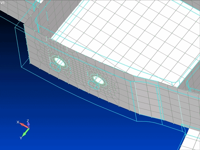

Non an option for tet. Too heavy model, too weak machines.
I'm sorry. I will explain better my question. Please forget the mess above.
1. I have solid model.
2. I do midsurface extraction.
3. Before meshing I create default Properties with no thickness assigned inside - there is 0
4. I mesh it and see that the elements have thickness.
http://files.engineering.com/getfile.aspx?folder=d...
Question is: where can I see it and adjust the plate elements thickness if under Model > Properties I see only one Property with thickness 0 and on model view I see 3 different thicknesses?
In other words what is the best way to control plate elements thickness.
Rgds,
Mateusz

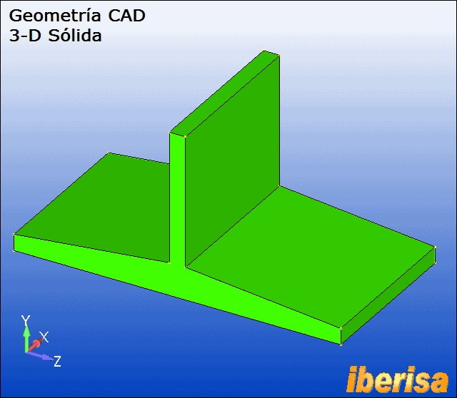

Dear Mateusz,

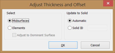

You can prescribe attributes on surfaces using command MESH > MESH CONTROL > ATTRIBUTES ON SURFACES, for 2-D shell CQUAD4 elementes this is the thickness & material properties. In your example the central thicker part will have different thickness, then you need to create a new property, etc... You can run this way, this is the classical aproach for shell meshing of midsurfaces, this is the way I do in general, but with FEMAP V11.2 you can also use the "magic" button to have only ONE property but many thickness & OFFSETs applied to the Shell mesh, great!!. This is the command "MODIFY > UPDATE ELEMENTS > MIDSURFACE THICKNESS AND OFFSET". This command attempts to update the element thickness and apply appropriate offsets for elements to better match the original solid used to create the midsurface(s).
The Select section allows you to specify if you will be selecting Midsurfaces themselves, which will then automat­ically select the plate elements associated with those midsurfaces, or any number of plates Elements. When the Ele­ments is selected, there is an additional option to Adjust to Dominant Surface. When enabled, Adjust to Dominant Surface will adjust the element thickness and offsets of all selected elements based on the surface of each Solid used to determine the thickness and offsets for the largest number of selected elements.
The Update to Solid section allows you to select how the solids used to determine thickness and offsets will be selected. When set to Automatic, each misdurface or element will automatically determine which solid to use, while when set to Solid ID, you will need to specify the ID of a solid or select s solid from the graphics window.

RE: Geometry > Midsurfaces > Assign Mesh Attributes
Hi Wnuczko,
you can modify the offset/thickness of your elements in
Modify --- Update Elements --- Adjust Plate Thickness/Offset...
Damn!!!
Double click to refresh! That what I was missing all the time :)
Thank you crostolo.
