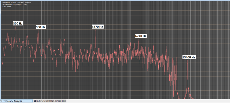

I ran the sound file through an FFT and got the spectrum below. The 300 and 900 Hz are fixed, of course, but the other peaks move with speed. Those peaks represent the whining sound. Not present in motors built with more distance between brush holders and risers.

Question for Mike:
We have checked the motor in a winder's shop and ran it through the whole speed range. The resonances are there, but we have a problem seeing exactly what is happening. There are several reasons for that - the stroboscope we had available is rather weak, and it wasn't synchronized with with the rotor. There is also very little space between risers and brush holders. We are trying to find a better strobe, synch it with the rotor and find a good mirror so that we can see better what is happening behind the brush holder and stabilizing ring.
My question is: Do you have any references, pictures or recordings that can help us explain the phenomenon to the motor manufacturer? They are sceptic and not willing to accept our explanation without any hard evidence.
We need to finalize the report by Tuesday and it would be extremely helpful to have your input Friday or Monday - if at all possible.

Send the motor guys to a fire station and have them examine a mechanical siren.
It also occurs that if the VFD is not completely stopping the motor before electrically reversing it, there could be large currents induced by said 'plugging' of the motor. I did that with a 1/15 HP ac gearmotor, and blew a 15A breaker right out of the breaker box. I did not photograph the remains of the breaker, which broke into little pieces on hitting the floor.
Maybe you can find a high speed video camera, which may capture flexure even without being synchronized.
For a small motor, you could rig a dove prism to rotate at ~half the motor speed, and look at the assembly along the motor axis with a telescope. The illumination would not have to be strobed, but your motor may be too big and too enclosed for any such rig to be practical.
Maybe you could rig up some soft plastic, maybe fibers like PlastiGage, adjacent the riser bars, and examine any witness marks left from flexure of the riser bars.

Thanks, Mike.
I was more looking for a documented case. Also, this is a DC machine so I think that mentioning a VFD was a slip of mind. And the high torque scenario (bridge failing to commute during braking) is not applicable. Operation is smooth and an occasional bridge short circuit would not produce fatigue breaks. There was no tripping and no blown fuses until the failure occurred.
The PlastiGage or similar technique is something to ponder. Will think more along that line.
We have been turning this problem inside out and tried to find a plausible explanation. There are torsional and flex resonances, but they are damped with a Q somewhere around 5 or less (estimate from impulse test) and they also do not produce forces that act in the plane where the risers are.
Your suggestion is the only plausible one, so far. But we need to either show the effect in a convincing way or find a case where it has been documented.
Anyhow, we now have a Shimpo DT 31 strobe that is rather powerful (xenon, not LED) and can easily be synchronized to the rotor and we will run a test on Monday. The synchronization will allow us to get a steady picture while changing speed slowly across the whole working range. A high speed camera is available at the nearby ABB HV breaker lab, but we haven't taken that step - yet. That would involve bean counters and would complicate matters more than we wish.

RE: DC motor risers break
Quote:
There are sound recordings where a whining sound that comes and goes. Much like a siren sound
If the siren effect is the cause, then the frequency should be:
MotorSpeed*NumberOfRisers
… or an interger multiple thereof.
That's one thing to watch for as you do your investigation if you haven't already thought of it (I'll bet you have).
(2B)+(2B)' ?
Yes, Pete. We can hear that frequency. See 10 Jan 16 10:53 spectrum.
Tests with a stroboscope didn't reveal much. Too bleak light. I have now put super bright LEDs (COB 2024) on a heat sink and protect them with some shrink tubing. See pictures below (dark):
I think you are saying one of the varying frequencies has been confirmed as number of risers times running speed.
That would be new info (to us reading this thread).
Would certainly tend to support the theory. (Although as you know not 100% conclusive, since that same frequency could also represent rate of brush passing over commutator segments, or possibly an electromagnetic slot-related frequency).
Good case study and look forward to hearing more.
(2B)+(2B)' ?
Yes, it is the 3370 Hz (and its harmonics) that moves with speed. The number of risers is 210.
The vertical scale is 6 dB/division, so the 3370 is quite powerful. Only around 4 dB down from the 300 Hz (6x50 Hz) and that is a lot of energy. Switching the fans off momentarily (we are running with no load) reduces that level a lot. So it is almost certain that it comes from air flow. Someone used the expression "air cavitation" which, incorrect as it is, still describes the situation rather well.
ok, then you've nailed down the cause of that frequency peak very well.
(2B)+(2B)' ?
So now all you need to do is link the noise frequency to the resonant frequency of the risers. Can you put a microphone near the risers, and "pluck" or hammer one to make it ring, and FFT the mike signal to see what the resonant frequency is? Obviously, if the passing frequency (siren frequency) gets close to the resonant freq. of the riser, there will be trouble.
Thanks, that is the missing "think link", Ben!
