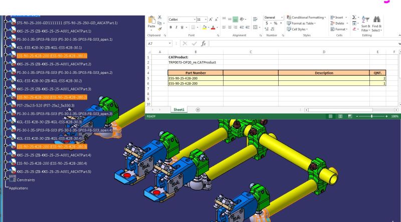

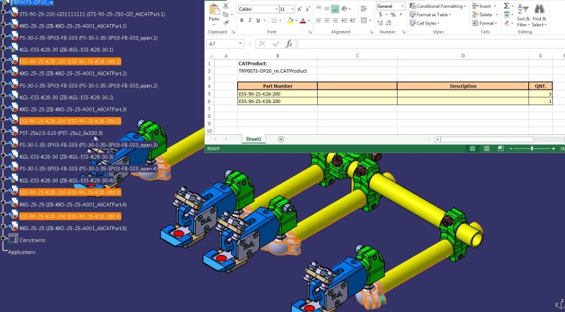

Hello, I downloaded a bom macro and attempted to modify to to our needs- unfortunately I am stuck on one final thing...
this is what I am getting when I select the 4 parts and run macro-
the macro appears to be counting the instance name (I think?) i would like it to tally only the part name.
this is what I would like to have happen when I select the 4 parts-
I really am a novice when it comes to coding, so any advise you can provide would be extremely helpful.
Finally, here is the code I am using...

RE: Modified Catia BOM macro
just curious... where did you get it from?
the instance name is ESS-90-25-K28-280.x
the PartNumber is ESS-90-25-K28-200
I have the feeling the counting is done on the PartNumber.
Now the code sees your PartNumber as 3+1 not 4... seems one is different from the other.
Could you check all PartNumber if there is any space after?

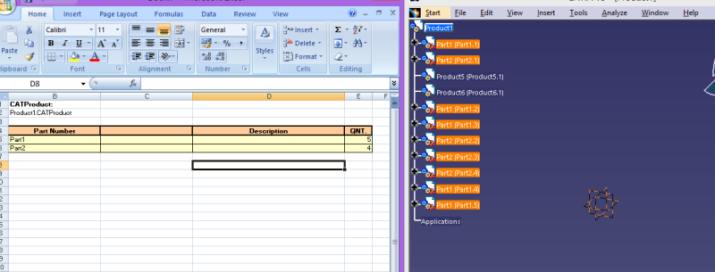

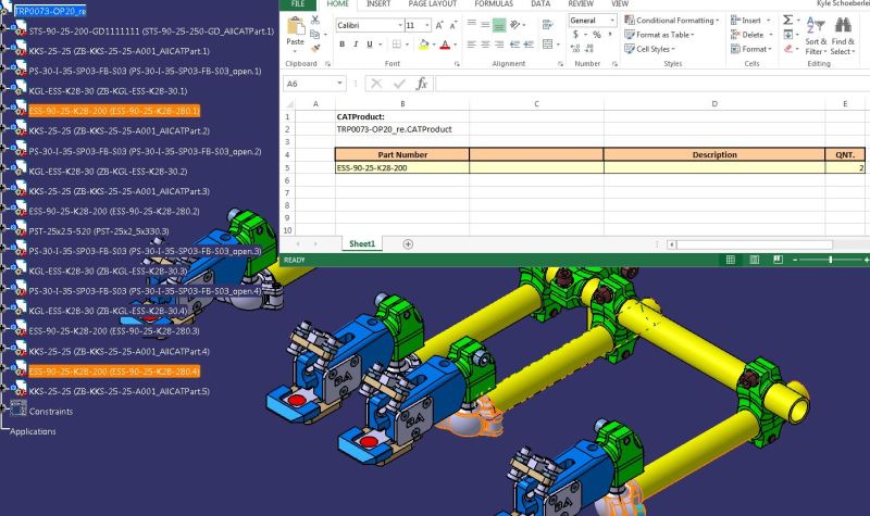

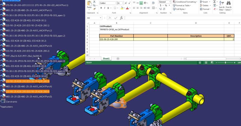

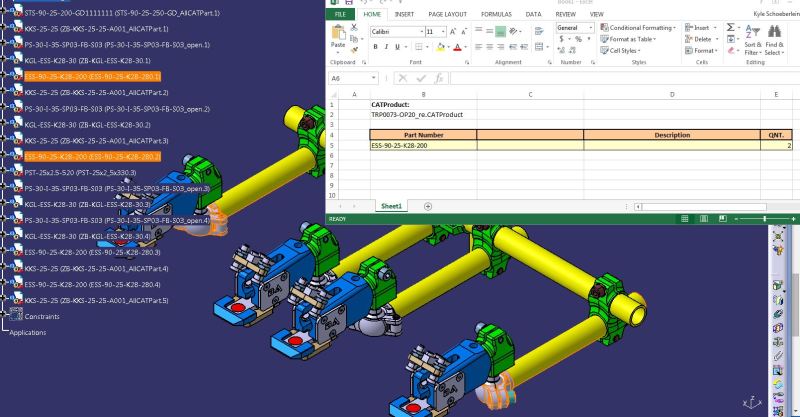

(I didn't come across any spaces or stray numbering)
However, some curious occurrences happened...
I ran the macro selecting the outer two... success
ran the inner two... success
an inner and an outer... success (then the other side... success)
when run a combination of any 3... this happens
finally, all 4...my initial result

If sel.count =0 Then
MsgBox "Select parts from tree.", ,msgboxtext
Exit Sub
End If
If sel.count >=1999 Then
MsgBox "Number of selected parts for BOM exceeds 1999. Program error.", ,msgboxtext
Exit Sub
End If
' ******************************* load ************************************************
for i=1 to prod.count
for j=1 to sel.count
if prod.item(i).name=sel.item(j).reference.name then
k=k+1
tab(1,k)=prod.item(i).PartNumber
'tab(2,k)=sel.item(j).reference.name
'tab(3,k)=prod.item(i).DescriptionRef
tab(4,k)=1
end if
next
next
' ******************************* sort ************************************************
if k>1 then
for i=1 to k-1
for j=i+1 to k
if tab(1,i)>tab(1,j)then
tab(1,1999)=tab(1,j)
'tab(2,1999)=tab(2,j)
tab(3,1999)=tab(3,j)
tab(4,1999)=tab(4,j)
tab(1,j)=tab(1,i)
'tab(2,j)=tab(2,i)
tab(3,j)=tab(3,i)
tab(4,j)=tab(4,i)
tab(1,i)=tab(1,1999)
'tab(2,i)=tab(2,1999)
tab(3,i)=tab(3,1999)
tab(4,i)=tab(4,1999)
end if
next
next
' ******************************* count ***********************************************
dim total, linecount, totalcount
total=1
linecount=1
totalcount=1
for i=1 to k
if tab(1,i)=tab(1,i+1) then
linecount=linecount+1
end if
if tab(1,i)<>tab(1,i+1) then
tab2(1,totalcount)=tab(1,i)
tab2(4,totalcount)=linecount
totalcount=totalcount+1
linecount=1
end if
next
end if
k=totalcount-1
' ******************************* output to excel *************************************
'for i=1 to k
'msgbox i & " " & tab(1,i) & " " & tab(2,i) & " " & tab(3,i) & " " & tab(4,i)
'next
Dim xlApp
Err.Clear
On Error Resume Next
' set xlApp = GetObject(,"Excel")
set xlApp = GetObject(,"EXCEL.Application")
if Err.Number <> 0 Then
Err.Clear
' Set xlApp = CreateObject("Excel")
Set xlApp = CreateObject("EXCEL.Application")
end If
xlApp.Visible = True
xlApp.Workbooks.Add
msgbox "Can't open excel.", ,msgboxtext
workbook.Close
xlApp.Quit
end if
row=1
col=1
xlApp.Cells(row, col+1).Value = "CATProduct:"
xlApp.Cells(row, col+1).Font.Bold = true
xlApp.Cells(row+1, col+1).Value = cad.name
row=4
xlApp.Cells(row, col+1).Value = "Part Number"
xlApp.Cells(row, col+2).Value = " "
xlApp.Cells(row, col+3).Value = "Description"
xlApp.Cells(row, col+4).Value = "QNT."
xlApp.Columns.Columns(2).Columnwidth = 30
xlApp.Columns.Columns(3).Columnwidth = 30
xlApp.Columns.Columns(4).Columnwidth = 50
for i=1 to 4
xlApp.Cells(row,col+i).Interior.ColorIndex = 40
xlApp.Cells(row,col+i).Font.Bold = true
xlApp.Cells(row,col+i).HorizontalAlignment = 3
xlApp.Cells(row,col+i).borders.LineStyle = 1
xlApp.Cells(row,col+i).borders.weight = -4138
next
' row=row+1
for i=1 to k
xlApp.Cells(row+i,col+1).Value = tab2(1,i)
'xlApp.Cells(row+i,col+2).Value = tab(2,i)
'xlApp.Cells(row+i,col+3).Value = trim(tab(3,i))
xlApp.Cells(row+i,col+4).Value = tab2(4,i)
for j=1 to 4
xlApp.Cells(row+i,col+j).Interior.ColorIndex = 19
xlApp.Cells(row+i,col+j).Font.Bold = false
xlApp.Cells(row+i,col+j).borders.LineStyle = 1
next
next
xlApp.Cells(row+i,col).Select
' xlApp.Cells(1, 1).HorizontalAlignment = 2
End Sub
THIS WORKS EXACTLY HOW I NEED IT TO!
THANK YOU! :)
it appears the count needed to be set to one... then I am not sure of the specifics.
if you don't mind- I'd like to know what factors you considered in the original code to draw your conclusion for this new code. I apologize if there is an obvious answer, but I am a novice and would like to be able to learn from this experience.
thank you again
Kyle
So I run the code up to the count, then executed the script line by line and looked at the values in the tab() array. I did that with a selection of 2 identical items, and again with a selection of 10...
That's how I found that the count section was not good.
if you look at the original script
CODE --> vba
' ******************************* count *********************************************** for i=1 to k-1 for j=i+1 to k if tab(1,i)=tab(1,j) and j<=k then tab(1,j)=tab(1,k) tab(3,j)=tab(3,k) tab(4,j)=tab(4,k) tab(4,i)=tab(4,i)+1 k=k-1 end if next nextFirst, when you do a for - next loop
CODE --> vba
CODE --> vba
B = 10 For i = 1 To B B = B - 1 Next MsgBox iwill show
all selected element are listed in tab(1,x) the count is listed in tab(4,x)
if one element (nth) is the same as the next (n+1th) then replace the next (n+1th) with the kth one in the list and add 1 to the current (nth) count and change the limit to the last one to (last-1)
that might seems ok but it is not:
let say we have 4 same elements selected:
tab(1,1) = part1 tab(4,1) =1
tab(1,2) = part1 tab(4,2) =1
tab(1,3) = part1 tab(4,3) =1
tab(1,4) = part1 tab(4,4) =1
let's follow the script
i=1 j=2 k=4 with i going up to 3 (k-1)
if tab(1,1) = tab(1,2) then tab (1,2) = the value of tab(1,4) = part1 and tab(4,1) is increased to 2 and k=3
so we have
i=1 j=2 k=3
tab(1,1) = part1 tab(4,1) =2
next j
i=1 j=3 k=3
if tab(1,1) = tab(1,3) then tab (1,3) = the value of tab(1,3) (not much change here) = part1 and tab(4,1) is increased to 3 and k = 2
we now have
i=1 j=3 k = 2
tab(1,1) = part1 tab(4,1) =3
next j
i=1 j=4 k = 2
as j>k then next j but j reach K limit of 4 so next i
next i
i=2 k = 2
j =3 to 2 so nothing goes here next i
next i
i=3 k = 2
j =4 to 2 so nothing goes here next i
next i
i=4 above the first limit of 3
we have :
k=2
tab(1,3) = part1 tab(4,2) =1
tab(1,4) = part1 tab(4,2) =1
excel will show tab(1,x) with count of tab(4,x) for all x up to k
tab(1,1)=part1 tab(4,1)=3
tab(2,1)=part1 tab(4,2)=1
I let you do the simulation with 10 instances of the same part...
I would have used a Dictionary with the part as key and the count as item
CODE --> VBA
I would have also change a bit the excel output script...and many other things...
