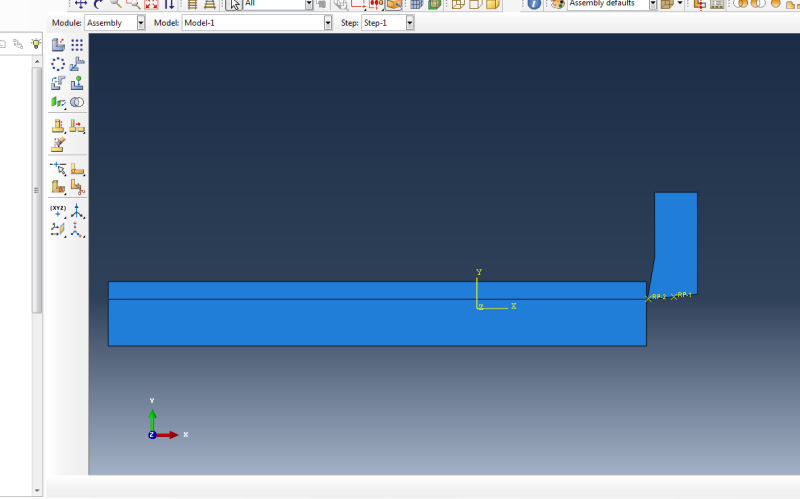

I am trying to analyse the forces during a cutting procedure in Abaqus/Explicit.
To do that, I have created a 2d model as follows:

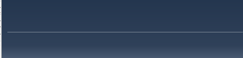

On top of the workpiece I have placed a wire-based part:

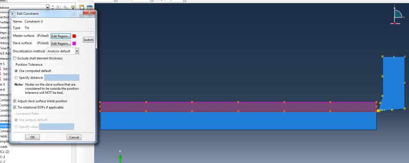

This wire is placed via a tie constraint as follows:

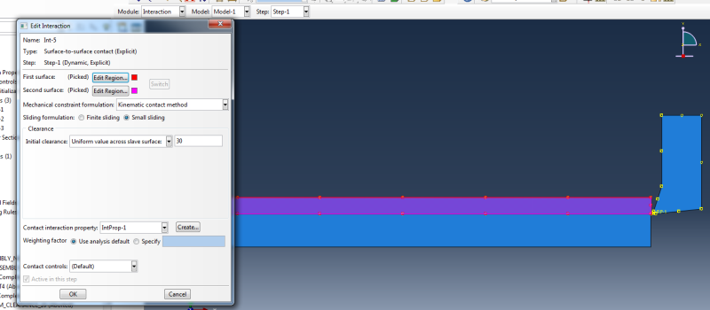

I use the surface-to-surface interaction to model the tool-workpiece interaction and one more interaction to model the tool-wire interaction.
Moreover I use one more surface-to-surface interaction to model the curl of the chip:

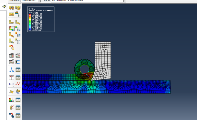

But this final interaction does not happen and my elements penetrate one another during the analysis:
Anyone has any ideas on how to resolve this contact problem?
