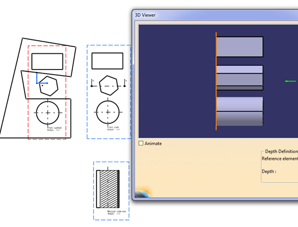

make the section from your top view
duplicate the top view
in the 2d top view, create a breakout view showing only your red zone
then apply the breakout to your section

you made a break out on the solid you want to keep... you should do the opposite:

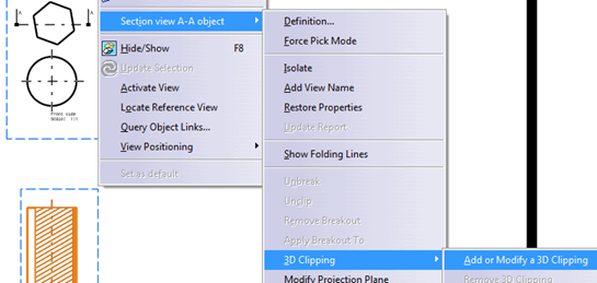

the other option is to use 3D clipping from the section... check RMB
