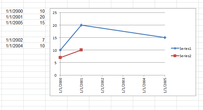

Looks like I was a little early in saying this was solved.
So the line graph works fine if all of you data has the same dates. However, I you try to add data that has a different date range, it does not plot correctly.
Here is a quick example of the problem I'm seeing with made up data. As you can see, series 2 is not plotting at the correct location relative to the x (date) axis.
Any ideas?
Mike Lambert
RE: Scatter Plot Scales
Here's your source data as it should be structured...
date   	  series 1	series 2
1/1/2000	10
1/1/2001	20
1/1/2005	15
1/1/2002		7
1/1/2004		10
You implicitly assigned your second table data DATEs to the secondary axis OR your x-axis implicitly changed from a NUMBER axis, which would include DATE, to a CATEGORY axis, which is simply point by point, rather than numerically proportional.

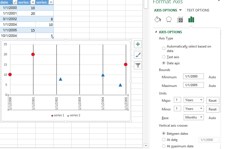

Sorry, IRstuff, that is not necessarily true.
In the data I posted there is no data for 2003, yet I have 1/1/2003 on the x-axis with no y-axis value obvoiusly.
The "trick" is to change the x-axis to DATE and the UNIT as YEAR. Solves the 365.25 problem as well.
Bottom line: If you want the effect of x-y chart with dates on the x-axis, to properly display irregular units (Month, Year) you need to use a Line Chart with Markers, Series No Line, Date Axis and appropriate Units.
Base Units. Good point!
And if you needed to plot Date/Time, the Line Chart would not do the job: You'd need a Scatter Chart, But then Months/Years would not be a display factor.
