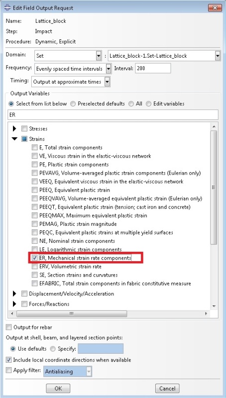

I'm simulating a drop impact test. I can find out the strain rate of the physical problem from dividing Velocity by Initial height, but how can I find out the strain rate from the simulation result data?

Can you please name the output variables for strain rate?

From version 6.14-1, Abaqus has introduced Equivalent plastic strain rate (PEEQR). Link - http://media.3ds.com/support/simulia/public/v614/r...
But I cant find the PEEQR output variable in either Field or History output dialogue box.
Any help?
RE: Strain rate of a simulation in ABAQUS/Explicit?
Yes, I have selected an element set, but its still not showing up.
ER = Total strain rate (available)
PEEQR = Equivalent plastic strain rate (Not available)

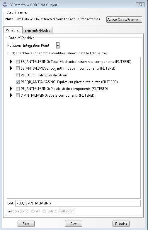

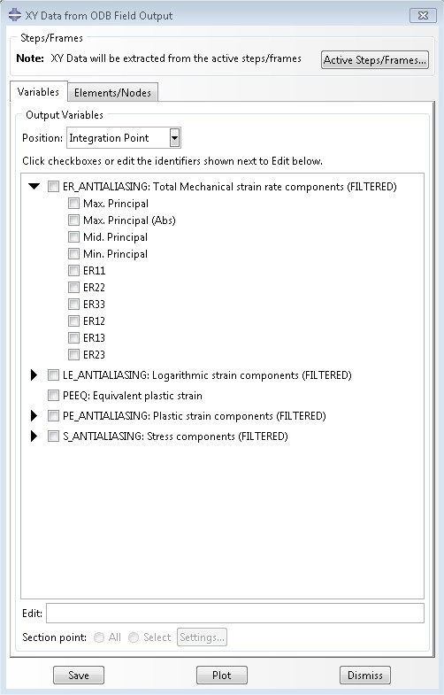

If it is not supported in /CAE, then you can add it in the Keyword-Editor or write out the .inp and add it there.
I have included the PEEQR keyword in .inp file, there was no error, everything ran fine.
But still no PEEQR output variable in .odb file. sad
For future reference -
PEEQR keyword is not supported in ABAQUS/CAE 6.14-1, but it is supported when manually editing the .inp file, only for *Rate dependent material models.
It will not be available in the .odb file if the rate dependent keyword is not present in the .inp file.
