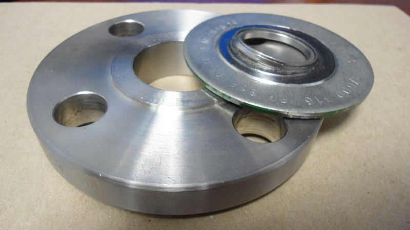

Quote:
So long as the two flanges are the same (class/rating, design code, type of flange face (FF/RF/RTJ), bolt size, PCD etc) then how that flange it attached to the corresponding pipe is not relevant to the flange itself.
If a WNRF is joined to a SORF, the raised face surfaces wont match at their ID, and can (easily) result in a spiral wound gasket to disintegrate since the last windings at the inner diameter of the gasket are not clamped together.
RE: Joining two spools of pipe together with two different types of flanges.......
Why would the two not match?
What size and class of which RFWN flanges differ substantially from their equal SORF diameter?
XL83NL is correct that in certain size ranges (at all sizes 1.5" NPS and smaller, but at some sizes/classes, as large as 8"), slip-on flanges whether used in pairs or in combination with any other flange facing, require SPECIAL DIMENSION spiral wound gaskets. Gaskets cut from sheet, or corrugated metal type gaskets, kammprofile type etc., do not have this restriction. Note that special dimension spiral wound gaskets are ALSO required for use on nozzle (long weld neck) flanges and on threaded flanges in some cases also.
Note that the suppliers of spiral wound gaskets, at least the people working on the sales desk, are often ignorant of this fact.
Note also that a gasket of the correct dimension may not comply with ASME B16.20. That's OK, unless you're working to a code/standard or client spec that requires your gasket to meet B16.20.
Otherwise, as long as the right gasket is specified, there is nothing to prevent you from mating any pair of flanges of the same size and class together, as long as they have the same facing, i.e. both raised face or both flat face.
If one of the two flanges is flat faced and made of a brittle material such as gray cast iron, you should not mate a raised face flange to a flat face flange. Otherwise, overtorquing the bolts may lead to a failure of the brittle flange.

I have a 4" WNRF flange mating with a 4" lap joint flange. As I understand it, the lap joint flange together with the 'lap joint stub end' will form a 'raised face' which will result in mating flanges with the same facing.
Craig.
Both the RFWN and the lap joint stub end will have the same bore, which is the ID of the pipe. No special gasket is required. Special gaskets are required when flanges have bores equal to or greater than the OD of the pipe, i.e. RFSO, threaded or LWN.

MSS lap joint stub ends have the same OD as the OD of the raised face of any flange of any class of that pipesize.
MSS lap joint stub ends can be machined with a serrated gasket finish (i.e. 125-250 microinch, 40-55 grooves per inch) like any other RF flange. But you can't machine "grooves" into them for use with O-rings, RTJ metal gaskets etc.
