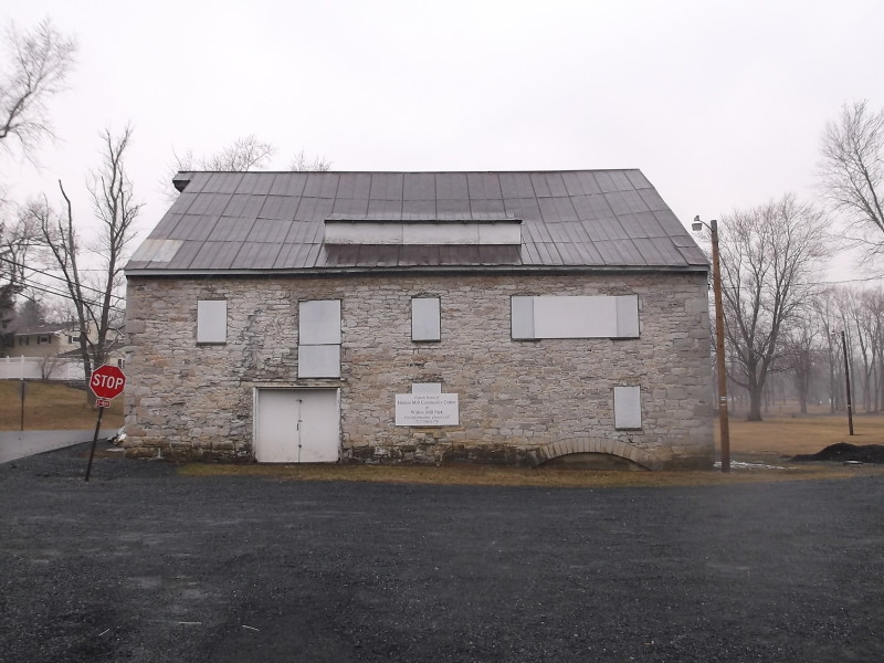

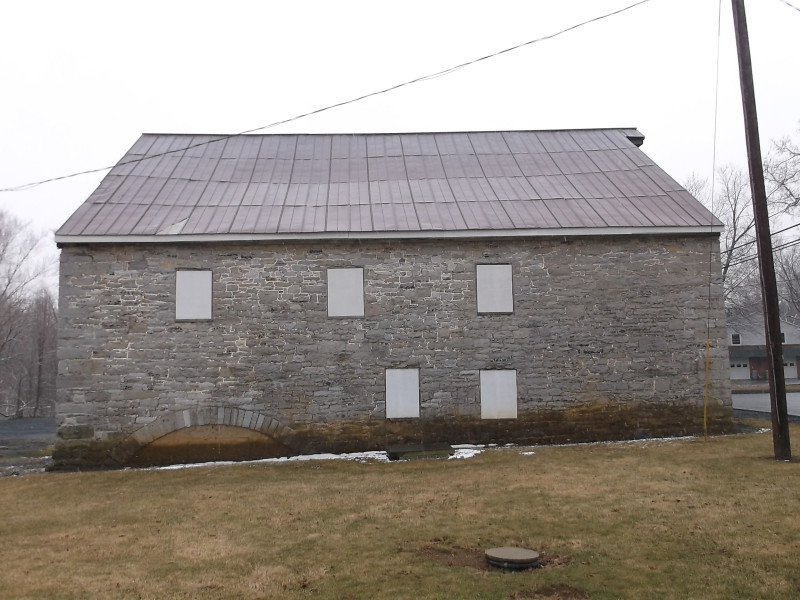

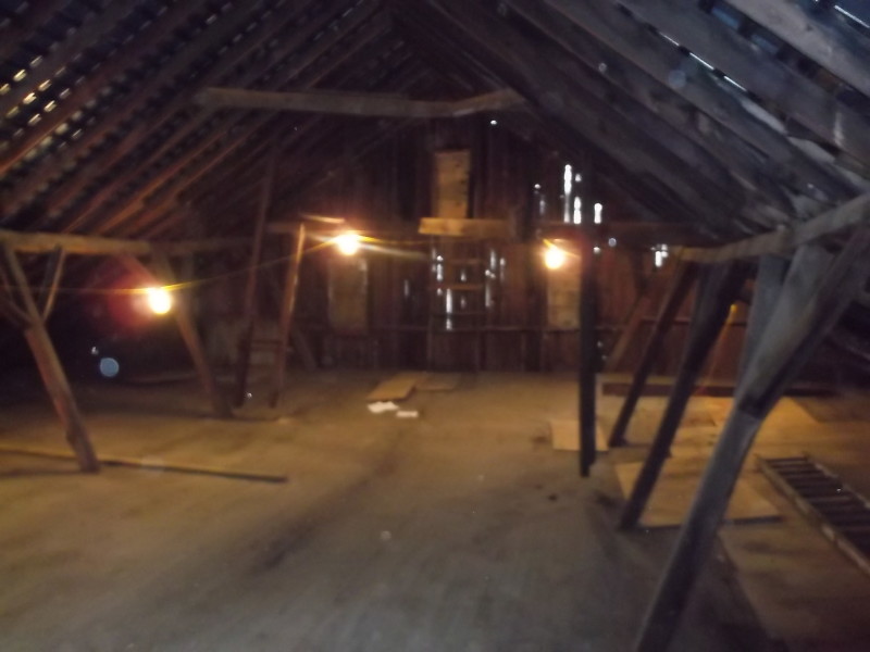

These are great projects. Any chance you could share a pic or two of the existing connections? I do not quite follow the existing connections. I figured out we were dealing with rough lumber.
I understand the need to upgrade.
RE: Wood Connections for Rehab Project
The first two pics show how severely bowed the roof is. The third one shows how the struts and purlin frame together. I really don't have a clear picture of the connections in question, because they just have these struts sitting right on top of the columns w/o anything to take up that thrust force. The only thing I can think of is that they assumed the floor beams sitting on top of the columns, which are 10x12, and the columns themselves, which are 10x10, to be stiff enough to resist this force. However, with forces I am coming up with I do not feel comfortable transferring that thrust force to the beam and column.
