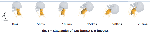

Thank you for your answers!
According to the literature this is the movement the cervical spine must have after a 7g acceleration impact:
As you can see the impact last around 250 ms.
I am using abaqus dynamic explicit.
Step time is 0.250
I am using gravity load of 98.1 m/s^2 and no amplitude. My reason for not using amplitude is because the acceleration in a colision is received all of a sudden, if I use amplitude, I would only get the 10Gs at the end of the job and that is not a real simulation dont you think?

You do not need to specify *Amplitude with gravity; there is no time-dependence for this body load! What you need is to specify displacement/velocity/acceleration profiles at one or more points in the cervical spine. Read works by Panjabi/Yang/King/Yoganandan/Hayashi for experimental evidence and finite element simulations.
