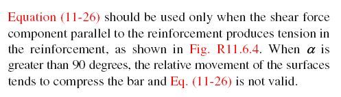

RE: shear friction reinforcement
I was thinking of the clause below. It came up here recently in the course of a bridge pier cap discussion. Upon re-reading it, however, it doesn't strictly apply to your situation.

I asked this question because I had a doubt since shear friction will be resisted by the dowels crossing the shear plane.
Therefore, since the section is reinforced from both sides, both reinforced sides will be resisting.
I don't think that anything prevents you from using the dowels from both faces of the stem wall. That said, I usually find that the tension face bars, on their own, are adequate. And I like it that way.
Calculate the shear friction using both layers of reinforcement. In order for the concrete to shear at the construction joint, it will need to separate and shift. Although compression zone stresses are not allowed to be considered (unless they come from tensioning strands) both layers of reinforcement, properly developed at the interface, will resist separation.
