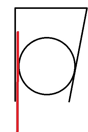

If you just want to hang the fabric as in Mike's magnetic holder, just make something like this roller in a folded channel (fabric is red). Or could be a roller constrained to a wall with two brackets.

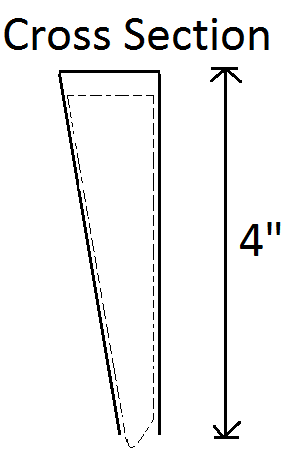

Thank you for the thoughtful input, creativity, and innovative thinking! I've attached a sketch of the prototype I plan to build with some additional design requirements. The Chinese fabric trap needs to meet these design requirements (1) have a variable insertion length up to 4" (as in you can insert as little or as much fabric into it up to 4") (2) Needs a holding force throughout the entire 4" column. Additional insight and thoughts are appreciated, if there is a better way please let me know! Special thanks to MikeHalloran.

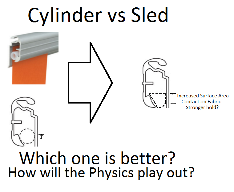

Additional Question - see picture.

Where is the c.g. of the sled? Does it center up - can it misalign? Keep it simple. Also, fabric will buckle more easily that paper, so keep insertion in mind.

Here is my updated design concept it provides force throughout the column and has less moving parts compared to using rows and rows of the roller system described above.

I don't think you can lift the wedge by pushing on it with fabric, unless the fabric has a lot of sizing on it or is remarkably stiff for other reasons.
... which is yet another reason that the wedge needs to be full-width not segmented, so that you can use strings or something to lift it by the ends and bias it to one side of the cavity, so you can work the fabric into the gap. It may even be necessary to evacuate the cavity or otherwise provide an airflow to carry the fabric into the gap.

Wedge vs roller.
Increased grip surface area does not equal stronger grip. (F = mu.N)
A lower mu between wedge and frame permits a steeper ramp angle. Steeper ramp angle has the advantage of reduced vertical displacement for a given "grip" displacement.
A planar grip region is more prone to over-constraint and high spots. Roller has line contact. Soft roller seems best option. Lightweight (hollow elastomer?) for easier fabric insertion. (why do you need

If I were designing a one time use system, that gripped and never let go I'd use a wedge. If not, not.

Weighted (or spring loaded) rubber roller with a non-reverse ratchet on the ends where it is mounted (NRR right next to the bearings.) As a bonus, if you pulled and then quickly released and started feeding, it would probably help start the fabric moving forward.
RE: High IQ Nerd Stumped on Simple Problem
Take 1gibson's roller and expose a section of the roller opposite the fabric as a thumbwheel like a mouse wheel to feed the fabric.
