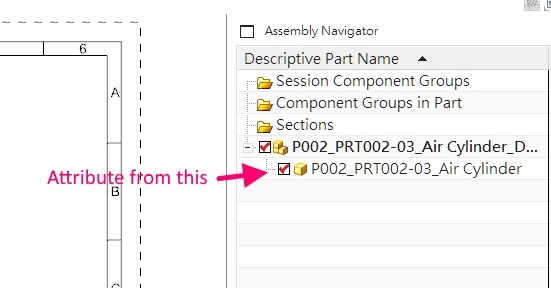

Hi John,
Attribute from the model while in drawing/drafting. Please see below for screenshot
thank you!

RE: Sync attributes
Yes, that is what I am trying to do; automatically populating the title blocks.
I use Master Model method. I put all the information (part material, part name, part number, etc) in attributes in the Model file.
When I create a Drawing from the Model, I would like the title blocks to automatically populate by reading from the attributes in the Model file.
The way I do this is by choosing "Edit Text" on the title block cell, go to "Relationship", click "Object Attribute", choose the Component (the Model), then select the attribute I want in the cell. If I click "Part Attribute", I cannot access attributes from the Model.
This all works fine with the very first Sheet (title block automatically populates and updates when attributes in the Model file change). But if I insert more Sheets (second, third, fourth, etc), the title blocks on these subsequent Sheets do not update or read attributes from the Model. Only the very first Sheet works.
Am I doing something wrong? Missing something?
Thanks!

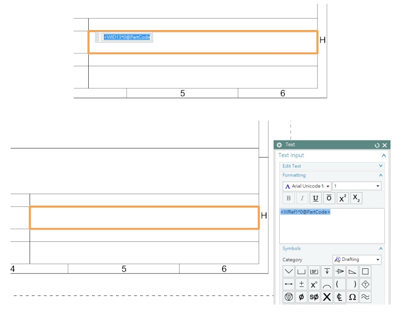

RE: Sync attributes
Ah, the interaction is new in NX10... No more "Insert Part Attribute". It's Insert Object Attribute now.
when you select "object attribute", then select the model in the assembly navigator
you should be able to select Part attributes from this model
The text in the note editor should then look like <WRef1*0@attributename>
( in earlier versions , i run NX7.5 ... the syntax is <W@attributename> )
I assume that if all your sheets have this syntax they should update. ( Else i need to learn some new stuff....)

RE: Sync attributes
When I put the templates into actual use, the cells in title block in very first Sheet has sytanx like <WRef1*0@attributename>.
In all the subsequent Sheets that I inserted, if I DOUBLE-CLICK the cells in title block, the small pop-up shown has syntax like <WID30*0@attributename>. But if I choose "Edit Text..." on the cells, they have syntax like <WRef1*0@attributename> in the dialogue box. In the very first Sheet, it does not matter whether I double-click or choose "Edit Text.." on the cells, the syntax are the same <WRef1*0@attributename>.
Please see below:
Is there a setting that I need to check on or off to get it working in all sheets?
