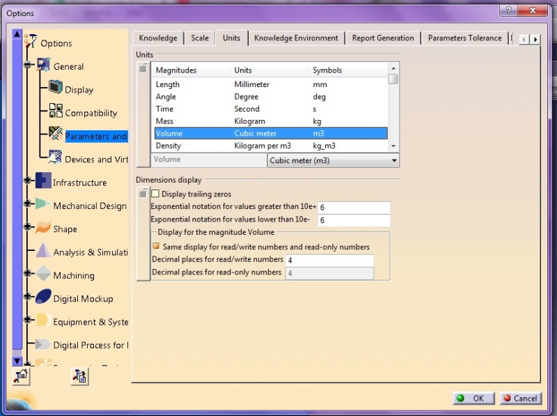

How could I switch the approximate volume calculation to exact?
The volume should be 0.0037.

.0037 four decimal places after point. change in catia settings value for volume to 4 decimal places

Thanks Jenial.
