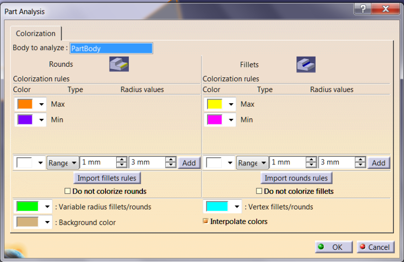

I have a stp file which i imported in Catia V5 R20. I want to find and remove all the fillets in range 1 to 3mm in this file. Is there any tool which can be used to find directly all fillets in considered range as i don't want to measure every fillet.

RE: fillet finding in range in step file
I already tried it.But it not select all fillet in given range.Also, don't show how many fillets in the range given .Don.t work with small range like 0.1mm to 2mm fillets (it will not shows fillets upto 1mm). only can be used with simple geometries.
Also, to remove these fillets we have to first change there colors and then remove them in which command generally show error.
Please tell if there is any other more effective method.
Of course removing fillets can give you errors. That's why companies have strict modeling rules...meaning fillets to be done at the end and try to not link other geometry to those fillets.
At the end, all depends on how the part was created...and for me is working also with smaller fillets then 1mm.
It looks like it is, but is this tool a separate license? If so, is the name of it simply "Part Analysis"?
