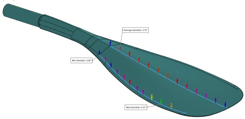

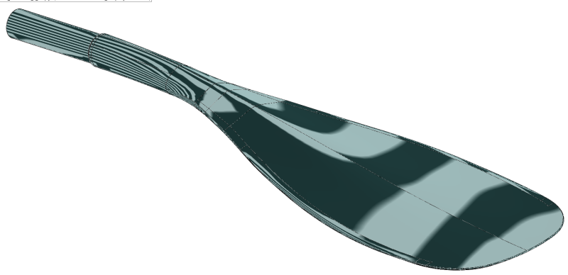

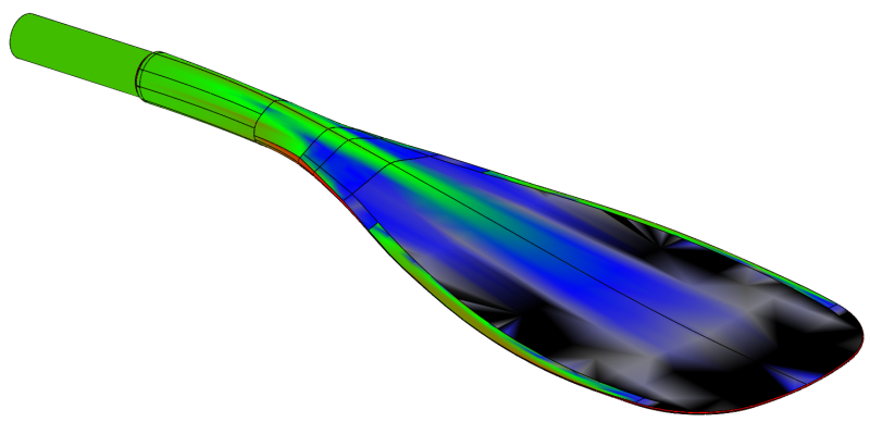

Cool kayak paddle. I would try to use boundary surfaces over lofts in general. Create the larger or most critical surfaces first. Starting again with fewer surfaces is probably a good idea. Be sure to use curvature, zebra stripes and deviation analysis as you go. Screen captures of your model with these diagnostics are attached below.
Once you rebuild you model post it up for other to learn or for continued help. I hope this helps.
Rob

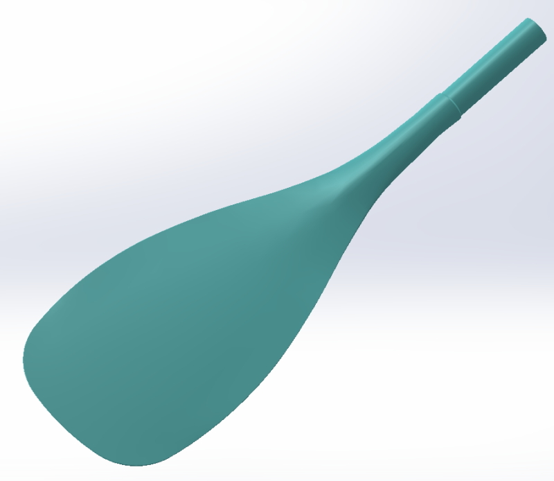

Hello again,
I have a very big success using lofts and boundaries and a small number of surfaces. But now a new problem occurs. I use the Freeform feature to make my desired shape, but it results in error with message that the face is self-intersecting. I run the Check feature and the is no gaps in the model. Also tried to make the Freeform just after building the loft surface (before knit to solid) and the same error occurs again. Attaching a picture and the SW file.
Thanks!
