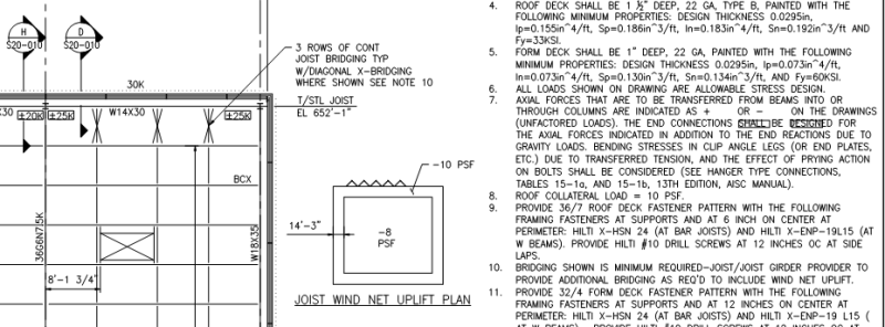

Do you have a photo that you can share? I'm guessing that what you're calling wind bracing is really joist bridging. And that would probably be good news as bridging would be less critical and therefore easier to deal with.
RE: Modifying windbracing
I do not have a picture, but I looked again at the structural framing plans and it is indeed called out as bridging. The plan specifically says, "3 rows of continuous joist bridging typ w/ diagonal x-bridging where shown."

Is this in a high wind area? The Steel Joist Institute allows for bottom chord and top chord bridging to be spaced independently of each other, but if this is a high wind zone, then the bottom chord bridging might be used to brace the bottom chord when it is compression from uplift forces. If that is the case, the bridging may not be able to be relocated. SJI gives some upper limits on spacing based on the slenderness of the briding, but this is probably a question the joist manufacturer should answer.
You generally need some bottom chord bracing, even if the bottom chord remains in tension under all load cases. That said, relocating the bridging line, perhaps in conjunction with adding another locally, should be entirely doable. Replacing the 1" bridging with 3/4" bridging may prove to be a solid idea as well.
If you're able, provide us with a scan of the relevant portion of that roof framing plan. Include the location of your sprinkler heads, the location of the bridging, and some indication of the zone over which obstructions are not allowed. You're still going to need a local structural engineer to sign off on it but we should be able to come up with a solution that has a very high probability of being accepted by whomever you wind up dealing with. It would also be good to know what kind of section has been used for the bridging. I'm guessing hot rolled, 1" angles.

I would have to dig deeper to find out if we are in a high wind area. The snapshot of the of the framing plan below shows a note about the joist wind uplift if that clarifies anything.
KootK
I've attached an overlay of the structure and my sprinkler piping at one of the problem areas. I've also attached the same area of the structural plan itself. The no-go zone on the sprinkler for object ¾" to 1¼" is 12" in each direction and 16" vertically down from the sprinkler deflector. The bar joists are 24" and the sprinkler deflectors are approx. 12" down from the top of the joist. I can't confirm the kind of section for the bridging, but 1" angles sounds about right based on my visual inspections from the floor.

It should be more than doable to move the bridging or replace the bridging. I would recommend contacting the joist Manufacturer (Vulcraft or New Millennium or Other) and ask them. They may provide a repair that you can then send to the EOR for approval. And you better mention to the GC that you are willing to pay for the time required :)

You could:
1) Delete the offending bridging line.
2) Add a similar bridging line one truss panel point to the right of original.
3) Add a similar bridging line one truss panel point to the left of original.
That should absolutely work and I would consider it the upper limit of what might be needed. The joist manufacturer or a local engineer can provably whittle that down to a single line of new bracing or maybe even nothing at all.
