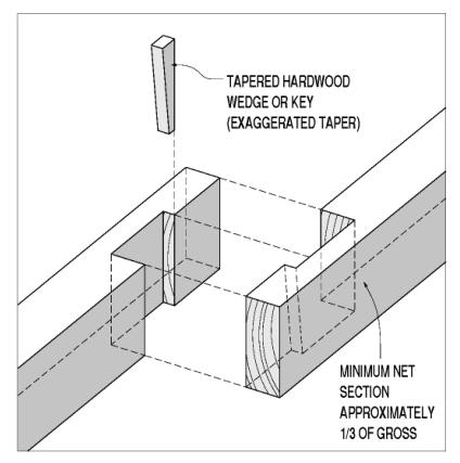

I think if the caliper happened to grab the rotor just after the loose splice, the reaction would be more like peeling off one segment, pivoting around the further bolt.
Machining an interlocking feature in the lap joint would provide some redundancy there.
Kind of like this, but without the wedge.
https://www.fhwa.dot.gov/publications/research/inf...
The short, flat head (?) screws aren't capable of much clamping, so may be susceptible to loosening.

I like the idea of a mechanical interlock to reduce the shear force on the screws. The screws are being sized off of these calcs so they are not definite at this point, however due to tapped thickness of one disc half I have selected 1/2"-13 screws to start. The disc thickness is 30mm so at the splice the tapped side is only 15mm and since I need the bolt sunk a little at each end I have about 13mm of thickness for thread engagement.
