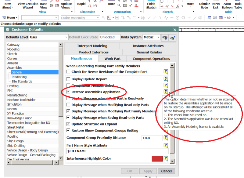

The NX assemblies application is a bit odd in the respect that once you have "ticked" it ON, it will be ON in your future sessions without any further interaction.
the problem is that new users to NX or "old users on new hardware" must understand / remember to turn it on, else the assemblies functionality isn't there. ( This is a very-very frequent support question...)
So, unless your company has some automatic utility to turn off the assemblies application, you will not need to turn it on again until you renew your hardware.

Actually this behavior, whether the Assemblies application remains enabled or not when you launch a new NX session, is controlled by a Customer Default setting, as shown below.
