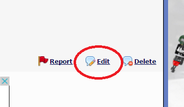

You know don't you that you can now go back and edit your own posts, at least for a day or so. Just look in the lower right corner of any of your recent posts and you should see an 'Edit' icon, as shown below;
Just keep in mind that after a post has been edited anyone can take a look and see what it was that was edited so you can't use this feature to 'rewrite history' or completely 'un-ring' a bell winky smile

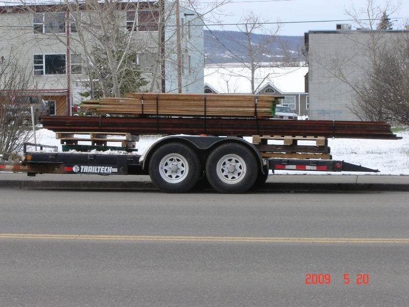

Here is some of my floors and my stairs before it got to the shop.
