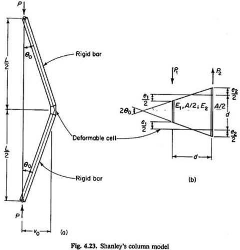

The difference, in my opinion, is the impact of connection rotational stiffness. On the guard rail, the load is what it is and that's the end of it. With the wall to wall connection and meaningful axial load, connection flexibility will lead to amplified moments at the connection as a result of P-little-delta effects. Shanely would not be proud.
