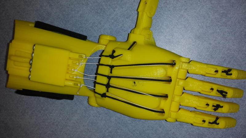

I am working on a project where joints are actuated by rope and bungee cords. Both of these are modeled with 3D splines because they follow a complex path. Can someone provide some best practices for this type of system?
Ideally neither the the rope or bungee would support bending or compression loads. These should also be pretensioned.

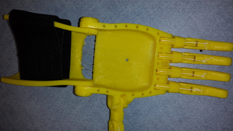

Well I now have second order hybrid truss elements (T3D3H) for a single rope. Convergence seems very unstable even with Automatic Stabilization on. Because I'm working with dumb solids, on the CAD side, the spline isn't laying on the hand and is floating in space near it's resting location. I expect that since the truss elements don't have any bending stiffness that they are causing the convergence issues. Once the rope is laying on the surfaces of the hand this should be alleviated. I'm running Abaqus 2016 so many of you probably can't open the CAE file but I would be happy to post it.
Any suggestions are welcome. Thank you.
