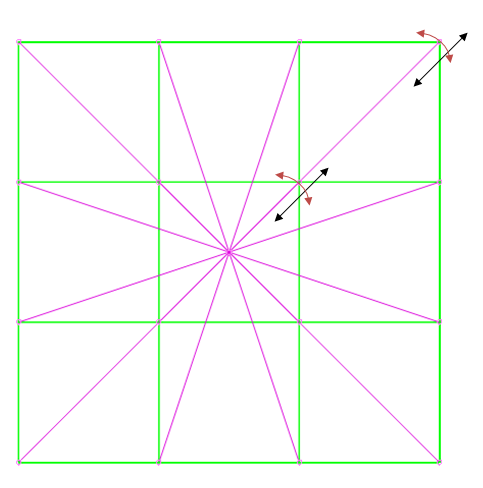

Following kinematic constrain definition should do the trick.
CODE
*ORIENTATION, NAME=PivotPlaneOri, SYSTEM=CYLINDRICAL
 0.0, 0.0, 0.0,  0.0, 0.0, 1.0
*COUPLING, CONSTRAINT NAME=KINEMCOUPRP,
           REF NODE=TOPRPSET,
           ORIENTATION=PivotPlaneOri,
           SURFACE=TOPSURF
*KINEMATIC
2, 3
I see one limitation. Nodes movement on the plane is not completely free.
They can deform along black directions but can not rotate along red directions.
If this is a problem for you the idea with contact plane from Mustain3 sounds interesting.
Regards,
Bartosz

Thank you very much, this is exactly what I was looking for!
Apparently I don't fully understand the kinematic coupling function. Why is it sufficient to couple displacements in circumferential and Z-direction if the reference node is displaced in X-, Y- and Z-direction?
I had tried a similar arrangement, swapping coupling in circumferential direction with radial direction, however, this doesn't converge. Why?
