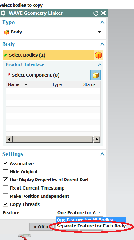

In the wave link dialog box (in the settings section of the dialog), make sure to use the "separate feature for each body" option.

Well that option is there in NX 9.0.3.4, as shown below:

Thanks John, I guess is a new feature.
