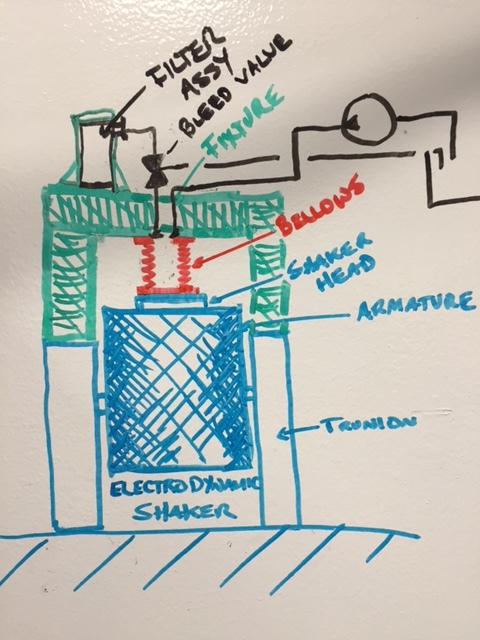

I have a requirement to test a hydraulic filter assembly 280,000 pressure cycles with pressure from zero (0) to 300 psi and back to zero (0) at a rate of 10 to 25 Hz with a superimpose impulse cycle of zero (0) to 90 psi and back to zero (0) at a rate of 210 Hz. A representative image would look like . Does anyone know of a way to generate this waveform. I need to be able to input a vibration controller and run it "open-loop" to drive the pressure into a bellows assembly to generate this waveform, but I need a function...??? PLEASE HELP!

Perhaps I am missing something but that is just two sine waves of two frequencies added together. Add a constant to the lower frequency wave so the lowest point is zero.
RE: Impulse Pressure Waveform
Because the frequency response of your actuator will not be flat, you will need the ability to control the amplitude of the two sine waves independently. You can then adjust each amplitude until the pressure signal is correct.
Not sure if you can do this with an off-the-shelf signal generator at a reasonable price, but adding two sine waves electronically is not difficult. Alternatively something like Labview would probably do it for you.

Ordinarily we would just use a servo valve and LabView to generate the waveform. The problem is the frequency of the superimposed waveform. I can't find a servo that will act that fast. The test doesn't require flow and essentially all the lines would be "fluid-solid" and therefore the pulse would just be a 'slug' of fluid moving with the displacement of the bellows. This is the only way I can imagine getting that cycle rate and being able to generate the waveform as the shaker system can be run "open-loop" so that I can can control the zero-offset as well as the input waveform. I still think this is like a FFT type waveform where one sinusoid is used to make the other, but I need some way of generating that function. This isn't clear to me.

The filter assy should be direct coupled to the bellows (large passage, minimum volume). The bleed/top-up system can be small diameter pipes since these are only controlling the "DC offset". This loop will have a long time-constant so I can't see any need for fast valves.

Think along the lines of a beefed-ed up subwoofer pushing/pulling hydraulic fluid inside of a contained hydraulic system. Some of the ideas in this thread are taking the LOONNNNGGGGGG way around problems. 210hz is not hard to do, even if you're on a DIY budget. That's not even fast by the standards of our slowest modern DAC/ADC systems, and the math to get that wave made is mid-level algebra. Designing your system to facilitate precisely controlled waves, without interference waves, is the hard part IMO.

The two sinusoids don't need to be related, in fact as I said earlier the amplitude of each needs to be independently adjusted. An electronics guy would find it trivial to generate this signal. In simple terms you could think of it this way:
Use two signal generators - one to generate each sinusoid. Feed the two signals into a summing amplifier. Job done. As you say, this part could be done open loop - simply adjust the amplitude of each sinusoid until the pressure waveform is correct.
Maintaining the correct "DC" pressure level probably needs to be closed loop for a 3 hr test. Alternatively since there are no potential leakage sites and DC drift will probably be mostly thermal, it may be sufficient to check the apparatus every 10 minutes and manually pump the pressure back up.
Your first diagram is not clear but it looks like the peak-peak limits of your pressure envelope are 0 - 300 psi? From the wording of the problem, I would have assumed a 0 - 300 psi waveform with 0 - 90 psi waveform superimposed for an overall envelope of 0 - 390 psi p-p.

The OP has posted a diagram above using a shaker and bellows to provide the input. Perfectly sensible. No valves are needed except for initial pressurisation and correcting drift in the static (DC) pressure level.
A pressure transducer plumbed close to the filter should satisfy the client that his tst specification is being met.
