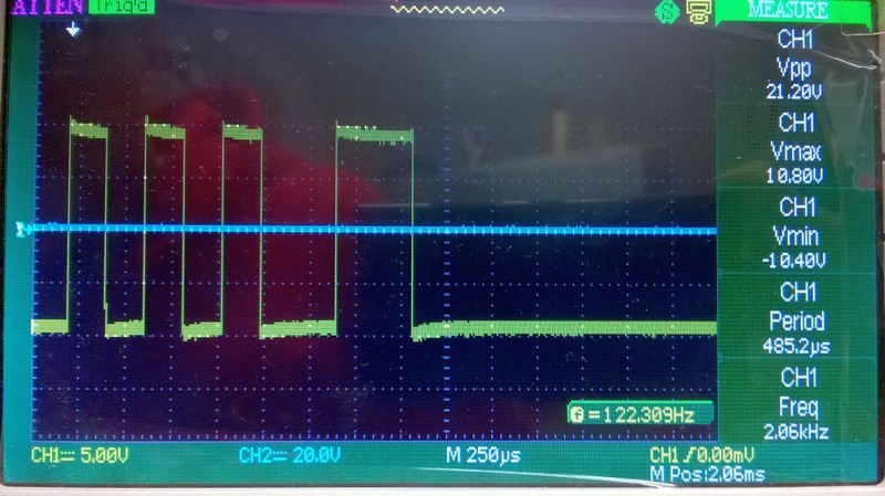

As you can see the peak voltages are approx. 10V and - 10V I think that such voltages should be acceptable for robot controller. I also made a loopback on my cable and got back in the terminal every char that I sent. However I still can't manage to receive data on Fanuc Teach Pendant. Sometimes I get error "DSR off when transmission" but sometimes program just wait for ages at the line READ RS232(xs). Can anyone take a look at my code? Is it ok?
To check what is going on with this "DSR" errors I measured voltage on pin 20 in DB25 male connector (that is on Robot side). There is a about 0.8V there. As far as I know there should be some significant voltage supplying bridged 6 and 8 pins with proper signal. Maybe I should use a full, null modem cable with handshaking instead?
