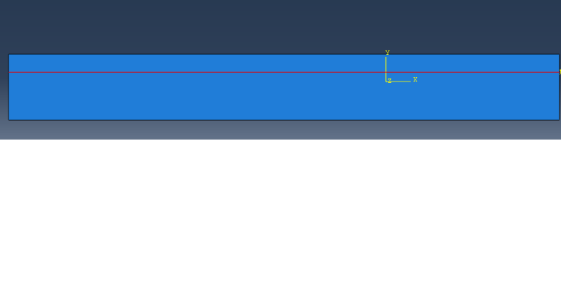

What I am trying to do is as follows:
In order to simulate a correct 2D orthogonal cutting process I need to create a contact between these surfaces :
and this:
which are on the same body.
I have implemented a self contact algorithm about the first surface, but then, when the chip is curled, two more surfaces need to be have a contact property:

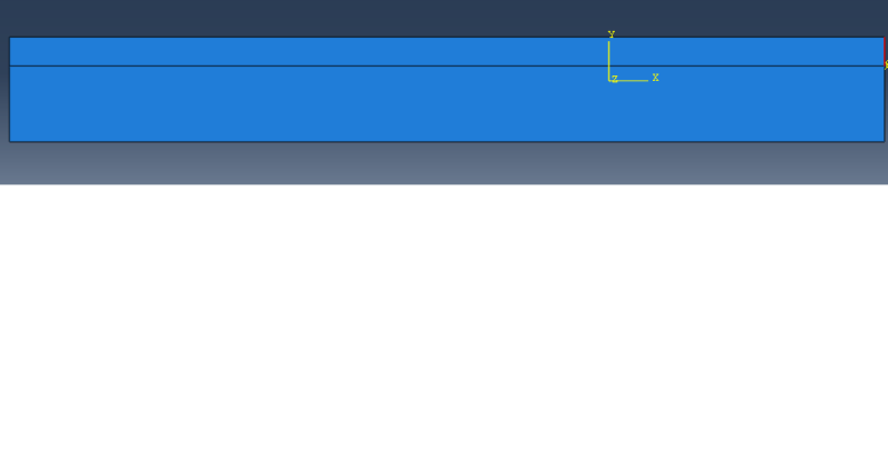

this one
comes into contact with this

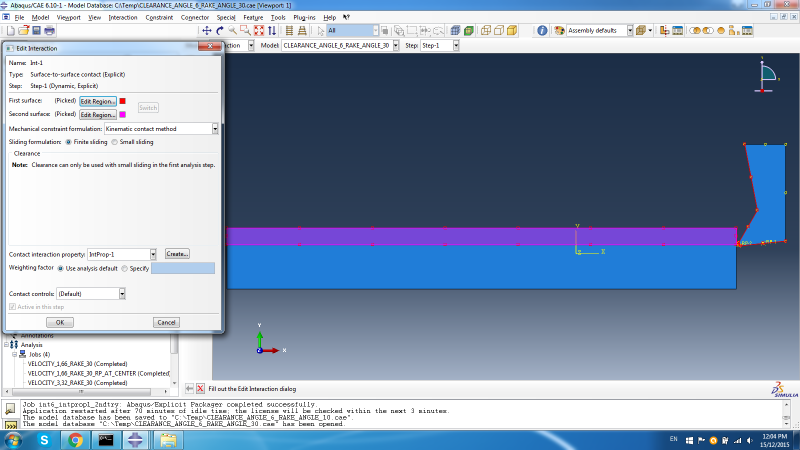

The only contact I have used is a surface to surface contact that is as follows:

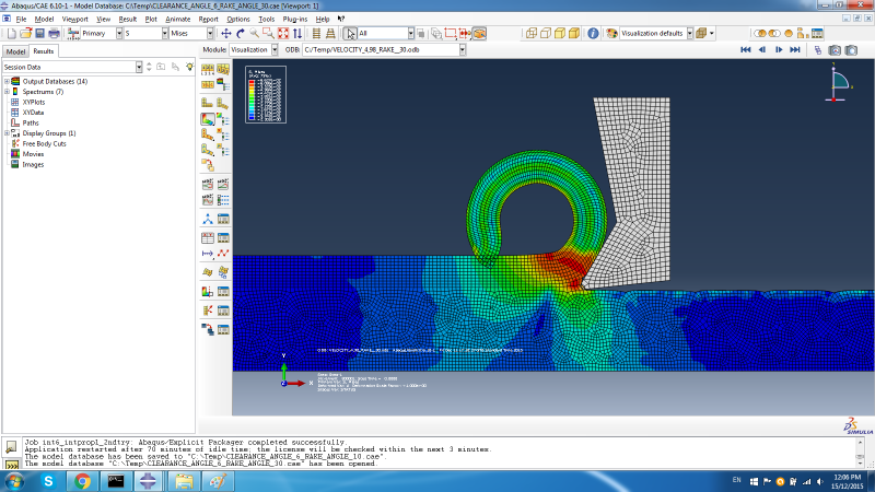

The result I get is:
My goal is to stop the elements on the tip of the chip to penetrate one another.

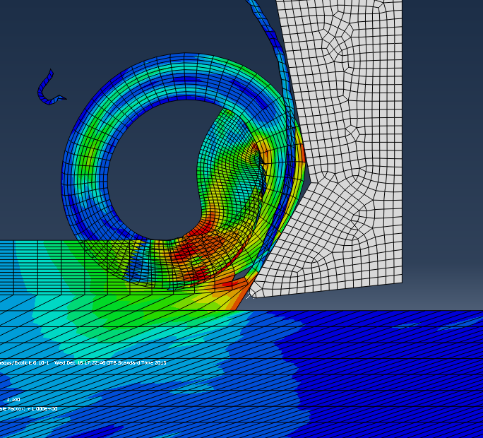

The self contact of the faces you mention does the trick for the given step time.
But if I change the velocity BC and give a higher value and the curl goes further this happens:
That is proof that the simulation still needs something.
If you or somebody else has any more ideas as to how I can define the contact between these surfaces in 2D I would be very grateful.

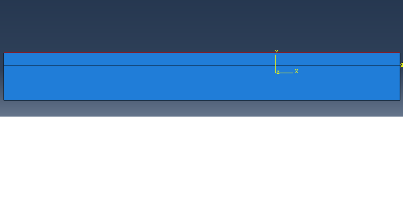

In this model, my workpiece is a combination of 2 parts (workpiece-chip) bound together by a tie constraint.
Moreover, a new wire based part is created and placed on top of the chip via a tie constraint.
Below you can see the assembly without the chip part.
The interactions I have now are as follows:
a surface-to-surface int for the tool-chip
a surface-to-surface int for the tool-wire
a surface-to-surface int for the chip-wire
The simulation runs, but for a very big value of the clearance in the final interaction window.
If someone has any idea I upload the .inp file file for references.
