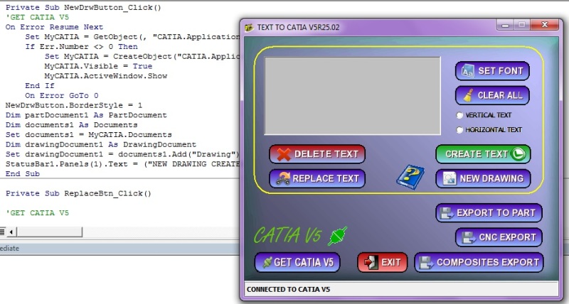

i know there are some programs/macros that can export text to part but the reason i got this one is catia composites.
we have to put some label on a plies so fabric cutting machine can write it on a ply. since Catia don't have too much options for creating label i did it thru macro.
for example in option for flatten geometries missing prefix and suffix. Dassault Systemes already got email from me.
thru a macro i can easily add what i want..
cheers...
created in vb6

RE: vb and catia connection
hi guys..completely changed design of my forms from buttons to images and now having problems with simulating button click action.. i use BorderStyle inside of my code but seems like it's not working. how do i force image to act like a button? any help will be really appreciated..
the reason i switched from buttons to images is just cool design..
looks nice isn't it?
i use http://buttonoptimizer.com for this

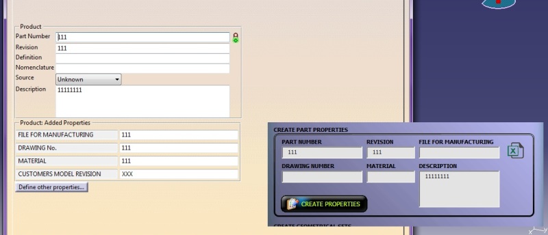

trying to improve my program and stuck with reading Product added properties. can't get a value of them.
everything work fine with regular properties
here's a code
CODE --> VB6
'----GET FILE REVISION----
    REV.Value = Product1.Revision
    If Product1.Revision = "" Then
    REV.Value = "NOT FILLED"
    End If
    '----GET TITLE----
    DESCR.Value = Product1.DescriptionRef
    If Product1.DescriptionRef = "" Then
    DESCR.Value = "NOT FILLED"
    End If
    '----END----
    '----GET FILE FOR MANUFACTURING----
    'FileFormManufacturing.Value = Product1.UserRefProperties.Item("FILE FOR MANUFACTURING").ValueFromString
    'If Product1.UserRefProperties.Item("FILE FOR MANUFACTURING").ValueFromString = "" Then
    'FileFormManufacturing.Value = "NOT EXISTS"
    'End If
    Status.Caption = "IDLE..."
    End Sub
i read properties at form initialize. highlighted code doesn't works for me.
any help will be appreciated.
