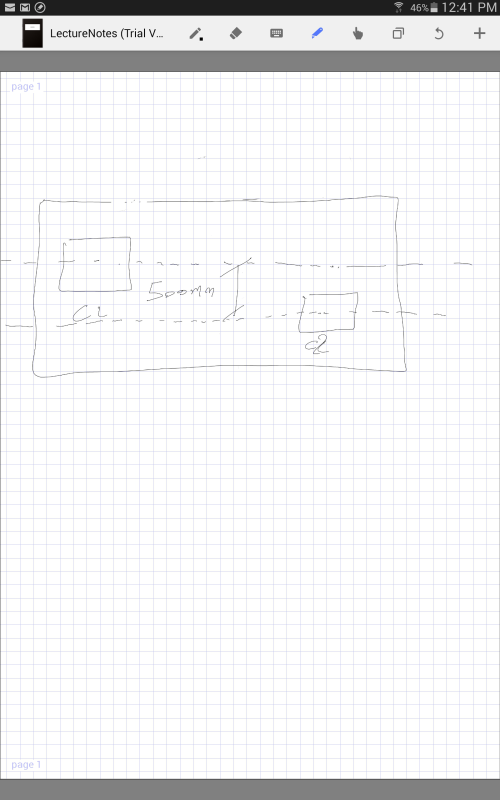

can anyone provide a an example/theory/equation , for calculating the reinforcement of a combined footing with 2 columns not on the same line ???
Any information will be useful :)

Why can you not build the footing so that the columns are both central to the footing axis? If this is a special case with required dimensions, perhaps you should provide a sketch.

Here is a quick sketch to illustrate the case (sorry about the bad sketching , i did it with my phone) .

What hokie said, skew the footing so both columns are on the centerline. Design like a normal combined footing except now you have diamond shaped columns instead of squares.

WE tried that guys, but it didn't work because we have some geometrical restrictions.

I'd model it in SAFE, but I'm guessing that may not be an option here. What kind of loads are you dealing with? Are these columns from frames or just gravity columns?
RE: combined footing with 2 columns not on the same line
Unfortunatly safe is not an option,i have to use hand calculations, the loads are only axial loads (gravity columns )

It is an option to skew the footing. Think parallelogram rather than rectangle. That said, 500 mm is nothing so long as your footing width will be substantially greater than that. You can probably just ignore the offset. Alternately, you could account for the offset locally at each column by designing the short direction at each end as eccentric footings.
Those geometrical restrictions should be included on your sketch so we understand the entire problem.

If i'm not satisfied with the Combined Footing result, i will size (2) separate footings and make all necessary design alterations to combine the (2)... i.e. worse case rebar supersedes, total required area, etc...
As others have stated, this depends on specific parameters and restrictions... need more info...

You have not indicated what your geometrical restrictions are. Not sure if this would work but you may try 2 separate footings and strap to counter act any eccentricities.
Yep, strap footings should work in the same footprint as your sketched footing.
