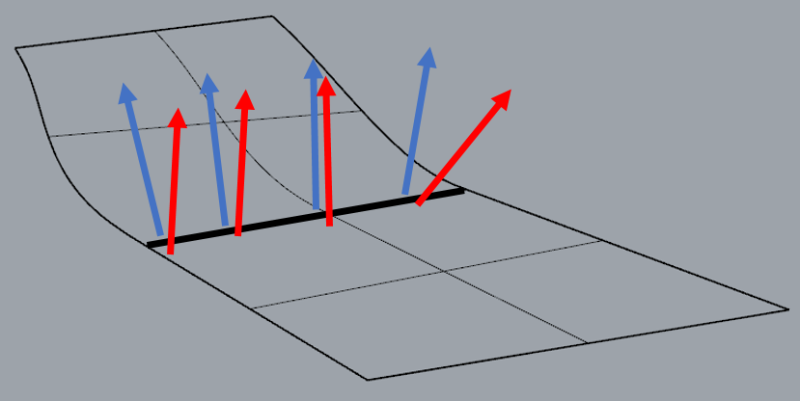

Hello and thanks for your reply.
In particular, I want to take a set of arbitrary points along the edge shared between two surfaces and then, for each of these selected points, I wanto to set the surface normals for each surface, forcing them to respect those imposed boundary condition (the normal vectors).
I hope I made myself clear.

I use NX 10 for Windows and yes, I want exactly to set the tangency between the two surfaces, but only one some selected points along the shared edge. In some other points I'd like for instance to set a fixed angle between the two normals.
RE: Set normal vectors on surface boundaries
Is it possible to do this kind of "selective tangency" operation?
Not interactively with any existing NX function, at least none that I'm aware of. Perhaps a custom application could be written using NX Open that would accomplish that.

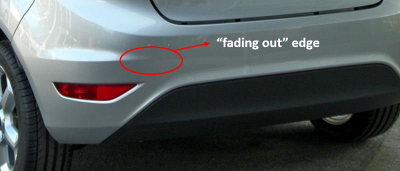

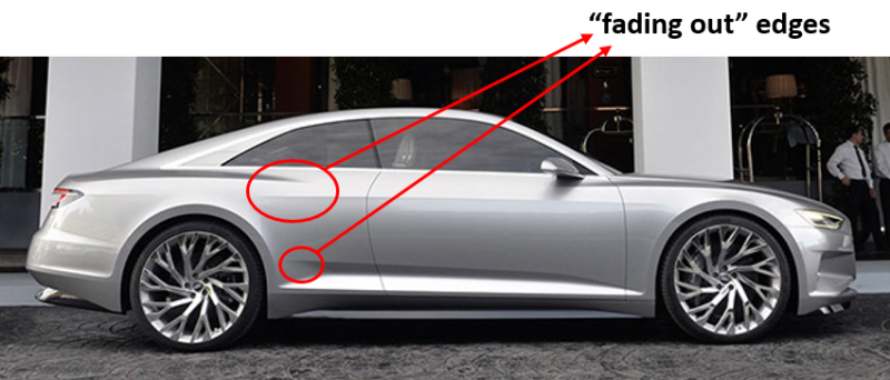

Hello again,
I tried to step back and watch my problem from a different angle, maybe by rethinking the basis of the problem itself.
Since my goal is to find a logic to reconstruct two surfaces, which may be tangent and/or not-tangent along their shared edge, first I have to understand how those kind of surfaces are modeled via the modeler/cad.
In particular, how are the surfaces containing this sort of "fading out" edge (crease) generally modeled in NX by a designer?
To better explain what I'm asking I think it will be useful to post a couple of examples.
Thanks again!
P.S.: I tried also to ask this in another section, since I'd like to understand the generic procedure (valid for various CAD environments) but they had suggested to ask the specific software sub-forums.

Here's a pretty simple version of transitional surfaces similar to what you've circled above (built in NX9). NX's Edge Blend has a nice option called 'Special Blend At Convex/Concave Y' that allows the blend to flatten out to an infinite value. You should be able to find it in the attached model.
The above examples are variations of my example, however, they are all going to be curvature continuous and would probably be a bit more difficult than my example to build due to both the shape of the larger surfaces and the higher level continuity (curvature continuous or G2) - however, the concept of transition is not much different.

In most auto design departments, there are two kinds of surfacing activity: the artsy stuff, and the production stuff.
The artsy folks are creating concepts. These concepts don't necessarily need to be realistic, and sometimes they are deliberatly unrealistic -- the stylist creates a "caricature" to emphasize some aspect of the design. The geometry created in this phase is not subject to any feasibility constraints; it just has to look nice. So, it doesn't matter too much if the shapes are too expensive to manufacture, or the engine won't fit under the hood, or the A-pillars are too thin to support the roof. The geometry is not used for much, beyond the concept evaluation phase. NX can be used to do this sort of work, but the guys doing it don't like to think of themselves as "CAD users", and they probably learned Alias in art school, so NX isn't used much. The market is small, so Siemens probably doesn't care very much about the artsy crew. Though I guess you could say that NX "Realize Shape" is an artsy tool.
Production "class A" surfacing (or "class 1" surfacing, at Ford) is an entirely different game. The geometry is real, it has to satisfy numerous different constraints (in addition to looking nice), and it is used to produce dies and structural body parts. For a long time, ICEM/Surf was the tool of choice in this area. A few companies use Alias, a few use Catia. Toyota and Honda both use internally-developed systems. There are numerous auto OEMs who use NX in this area. I can think of at least two that have switched from ICEM/Surf to NX. As one of the other replies mentioned, there is significant benefit to using the same system in production class A surfacing and in downstream engineering/manufacturing, so the companies who use NX for all of this are typically happy.

Back to the original question.
trying to actually design something by assigning vectors ( or angles) along an edge like that is like trying to find the matches in the darkness, difficult. - It's hard to guess what angle or vector will look good.
But, NX does more or less have this function, as a part of the Law extension surface .
Attached is a version of the part Tim uploaded, with both methods included. (My version is quite different from Tim's.) NX10.
The Law extension example is eyeballed towards the spline used in the upper example. The angle is ...

Yes, going back to the original question is a good idea.
As the previous reply indicated, NX has functions like Law Extension that let you control angle variation. But I doubt that you know what the desired angles are until you see the result and confirm that it looks good. In other words, the correct angle is an output of the design process, not an input.
The ICEM crowd would create this shape by pulling control points (poles) around. In fact, they do everything by pulling poles. So ...
(1) Create a simple surface (one patch, degrees of around 2 x 2).
(2) Split it into four patches, call these p11, p12, p21, p22.
(3) Modify the poles of one patch to produce the non-tangency, while keeping the other 3 joins tangent.
The trick is that moving poles that are two or more rows away from an edge will not affect the edge normals.
(4) If you need a more complex shape, gradually increase the degrees to give yourself some editing freedom. But, the more freedom you give yourself, the more difficult it is to keep the surfaces smooth.
