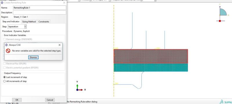

hello,
I simulate a mechanical joining method "clinching": 2D Axisymmertic in Dynamic Impl
I try stamping two sheets (deformable) whit a punch rigid. I used simple contact friction 0.2
During the simulation the edges in the end of the sheets don't move. The stress around the punch becomes very important and the elements are distorted [banghead]

For that level of deformation you may need to use CEL or adaptive remeshing. The edges of the sheets not moving could be due to your friction value. Since this is an axi-symmetric analysis out of plane wrinkling is not possible. The edges of the sheets will be in tension similar to a punch shear test.

RE: Axisymmetrie problem
Rob, thanks for your answer!
I tried to use adaptive re-meshing but i have a error message about the "error variable"
--> no error variables are valid for the selected step type

The results look like the speed of the tool movement is very high. The surrounding material has no time to move. You should check if that is correct and reflects the reality.
