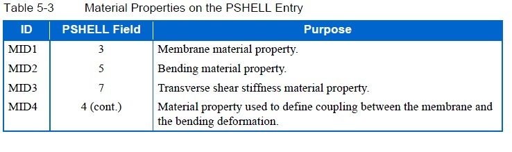

So, as expected, I am having issues with replicating smeared laminate procedure in NASTRAN. The test case I have is a Gr/EP Wet Laminate subjected to uniaxial Tensile load. The geometry is a simple rectangular plate of dimensions 5" (L) x 5" (W) x 0.22925" (t). The laminate config is 6 plies of 0 degrees & 1 ply of 90 degree. Each ply thickness is 0.03275". The loading is 2000 lbs/in.
I followed instructions provided in the AERSYS-7001 document for which the link was provided earlier, to compute MID1,2 & 4 matrices. I am posting the values below
Quote:
[A] =
[4.04E6 8.31E4 -2.2E-3
8.31E4 9.02E5 -2.5E-2
-2.2E-3 -2.5E-2 2.75E5]
[B] =
[-6.1E4 0.00E0 -2.2E-4
0.00E0 6.17E4 -2.4E-3
-2.2E5 -2.4E-3 -4.8E-4]
[D] =
[1.73E4 3.64E2 -2.1E-5
3.64E2 7.32E3 -2.4E-4
-2.1E-5 -2.4E-4 +1.2E3]
t = 0.22925"
t^2 = 0.05255
t^3 = 0.01204
MID1 = [A]/t
MID2 = [D]*(12/t^3)
MID3 = (B)*(-1/t^2)
MID1 = [ 17622682.66 36.24E4 -9.6E-3
36.27E4 39.34E5 -10.90E-2
-9.6E-3 -10.90E-2 +12E5]
MID2 = [ 1.72e7 3.63e5 -2.09e-2
3.63E5 7.29E6 -2.39E1
-2.09E-2 -2.39E1 +1.20E6]
MID4 = [ +116.08E4 0.00 +41.86E-4
+0.0 -117.41E4 +45.67E-3
+41.86E-4 +45.67E-3 +91.35E-4]
Here is the some contents of the BDF file
Quote:
PSHELL 1 1 .22925 2 1.
3
$ Referenced Material Records
$ Material Record : MID1
$ Description of Material : Date: 15-Dec-15 Time: 10:05:06
$ Membrane material properties
MAT2* 1 1.76227+7 362400. -.0096
* 3.934+6 -.109 1.2+6 .055
$ Material Record : MID4
$ Coupling material properties
MAT2* 3 1.1608+6 0. .004186
* -1.1741+6 .04567 .009135 .055
$ Material Record : MID2
$ Bending material properties
MAT2* 2 1.4368+6 30232. -.0017441
* 600500. -.019935 102160. .055
The expected axial stress is 64,400 psi. But I am getting a peak stress of 8950 psi.
Also, I was getting 9050 error. "USER FATAL MESSAGE 9050 (SUBDMAP SEKRRS). RUN TERMINATED DUE TO EXCESSIVE PIVOT RATIOS IN MATRIX KLL". Had to use PARAM, BAILOUT, -1 to proceed. The nodes on which load was applied were experiencing out-of-plane translation & rotations (per BDF file).
I would appreciate experienced folks to debug my bdf file is possible and let me know where I could have gone wrong.
