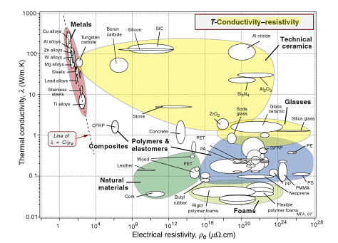

Well, given that we are engineers here we like to know numbers. So what is your desired thermal and electrical conductivity? What are your other requirements?
Al2O3 is a material with a high electrical resistivity and reasonable thermal conductivity, but scarcely seems a likely replacement for vinyl.
What do your competitors use?

I don't see them on the chart but there at TIM materials, thermal interface, used in electronics. They are electrical insulators and good heat conductors. These are the little pads on top of a CPU or GPU chip before the heatsink is mounted. I presume that you buy this stuff in sheets.
