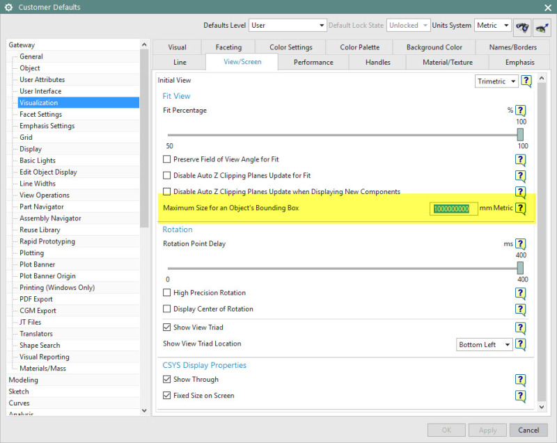

You don't have to set that variable anymore, there is a customer default (can't remember what version it appeared in).
File -> Utilities -> Customer Defaults -> Gateway -> Visualization -> View/Screen -> Maximum Size for an Objects Bounding Box.

RE: Question about the 500 Meter Limit on NX .PRT Files - Limit only for Components, or Assemblies to?
Yea, I forgot that we added this option to Customer Defaults, which has been there since at least NX 5.0.
