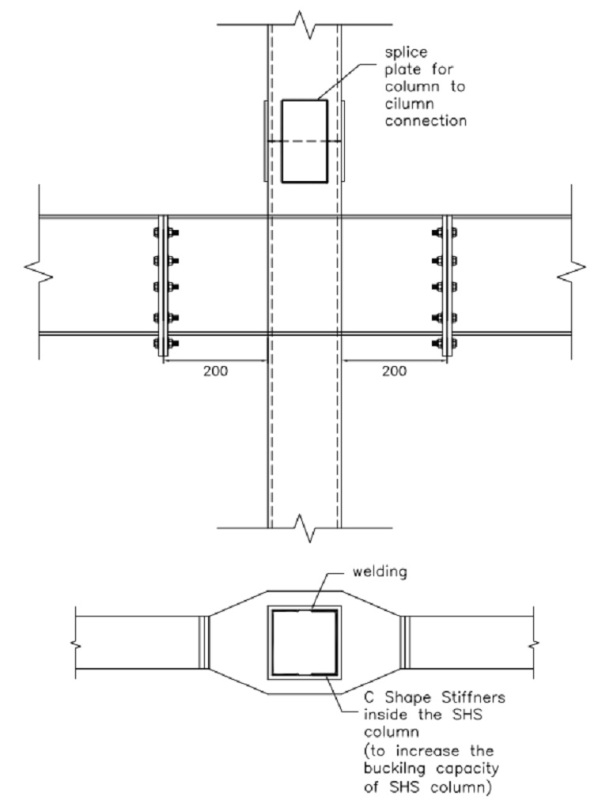

Please review the moment connection and suggest this scheme is reasonable to transfer the 250 KN-m moment each side into the SHS column
Please also suggest the SHS column wall thickness is 10 mm is enough against bending for 250 KN-m Moment.
any excel sheet or software to design this type of connection ?

Interesting configuration. I think that the stiffeners on the column will be problematic. They'll tend to plastify the tube walls locally.
RE: Moment Connection with SHS Column
I'd agree with KootK, you'll have an easier time if you use two stiffeners closer to the walls of the HSS tube.

Another option might be to pass the beam stub through the column and use segments of SHS as stiffeners. It would be more expensive though and you'd want your beam flanges wider than your column.
Calculate the couple force resulting from the moment in each flange, and simply check D.G 24 chapter 7 checks, and for the shear, it will affect the web only check the shear tab punching check for the HSS from the same reference above.
the stiffener u added will not do u any good, i think you will have to use a thicker SHS thickness at the connection location.

I am using British code. Any reference from British code to check the SHS local buckling?
My SHS column is failing in local buckling due to the large moment (250 KN-m each side of column), so how we can increase the local buckling capacity of column, any suggestion?
If I weld the 6mm plate on all 4 sided of column at connection location only then what you think it will increase the buckling capacity of the column?
And second option in my mind is that to use the thicker SHS section at connection location but I am confused how I will splice the column from top and bottom and it is also a difficult fabrication?
Which option is better please suggest.

I don`t recommend using a 6mm plate on the wall, it will not work with the SHS wall at the tension flange, the easiest solution is to use a thicker SHS wall thickness at the connection location, splice it with a full penetration weld and backing bar.

I was typing as KootK posted on 9DEC15, 14:19, and when I saw his post I quit typing because he said essentially what I was going to say. But, it seems like this relatively clean detail went right over everyone’s head, in favor of more complicated details. Use your end pl. moment connection, but use a 2 or 3' long stub of a WF beam with wider flanges than the HSS width, but the same depth of the rest of the beam string. I don’t understand why you need six small triangular stiffeners on the end pl. on the stub, at the stub web, and then not on the longer beam at that same moment location. Explain. If you use a heavier WF stub which is 5, 6, or 7' long your moment will be lesser in demand. This WF stub is welded to the top of the lower column. The next column up has a moment capable base pl. bolted or welded to the top of the WF stub. Cut a length of the same HSS tube with such length that it fits btwn. the inside of the WF stub flanges vertically. Then rip this short section of HSS tube so that the two halves match the outside widths of the columns above and below, and fit into the WF stub web on both sides. In effect, you will rip out some HSS web material to match the WF stub web thickness. Clip the HSS webs to fit around the radius at the flg./web ‘k’ area’ on the WF stub, and don’t weld into these corners. The bottom column now forms a “T” and is all shop fab’ed. This gives you beam and column continuity with relatively clean detailing.

The sketch below shows the option that dhengr and I have been proselytizing about. I've also included a second option. I would consider both to be high demand solutions. If you can get the numbers to work on some of your earlier proposals, they may well be cheaper to fabricate. Now that I look at it, my #2 was actually included in ameyerrenke's doc. I'm not sure that it has any advantages over the bypass solution though other than, perhaps, space savings.

I found the middle way from your option A & B to keep the more simplicity as show below (we need the plane surface on the top because we have the hollow core slab on it and we don’t want any notches in slab)
I have still following doubts regarding this please clarified so I can finalize this connection.
Does the inside 'C' shape stiffeners will provide enough resistance against buckling; however we cannot weld this stiffeners all-around because of space limitations? Can we use simple plate stiffeners instead of C shape stiffeners inside the column wall to wall at connection location or for more simple fabrication can I weld the plates outside wall SHS column for increasing the thickness of the section ?
The moment connection plate of the stub and main beam will be design with normal checks or need some additional checks to design this kind of plate?
I am keeping the stub length as minimum as I can keep (200 mm long) because the moment will be more with large lever arm what do you think about it?

You've misinterpreted option one. Please review my sketch again. The beam passes through, not around, the column. The column stops below the beam and resumes above it.
My understanding has been that your bolted connection is a moment connection. If that's the case, then your negative moments should be highest closest to the column. I imagine that you'll want to keep your beam stub fairly short for shipping though.

I am happy to say that we have the software that can easily deal with such connections, and calculate the local buckling effects. I created and analyzed the exact connection that you have in your drawing, and i am attaching a screenshot that shows the strain check. As others have commented later this specific configuration produces huge amount of stress in the column, and that is clearly shown in the picture.

I agree with KootK, the bolts at top flange are not properly placed and there is a 600kN and some tension travelling through.
Consider other options:
- Change UB stub to 2/PFC's each side of column or replace entire UB with 2/PFC's
- Change column to UC and detail a moment connection to flanges
- Increase size of beam and make it simply supported if it's not a cantilever. The cost will be lower due to simplicity of simply supported beam connection.
