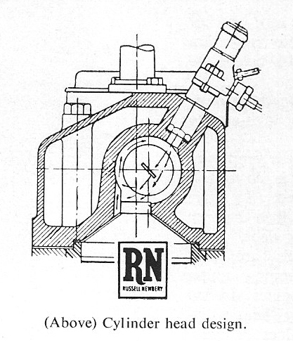

A history lesson: The clerestory (clear story) engine could, if you wanted to, be described as a "real" side valve engine, although not of the "flat head" variety. In the clerestory combustion chamber, so-called because there was some slight similarity to the clerestory building architecture, the inlet and exhaust valves approached the chamber from the sides. The inlet valve was typically in a cage, which when removed, gave access to the exhaust valve immediately opposite. To make the combustion system work, bulk air swirl was necessary, and this was provided by a poker piston and by positioning the swirl chamber off center so that the air entered tangentially. The initial premixed burn impinged on the reduced diameter of the poker, then the main expansion acted on the full piston diameter, thus reducing the diesel knock noise.
Many British engines (and maybe others) from the 1930's up to through the 60's used this system, usually in naturally aspirated form in which case they would typically develop about 7 bar BMEP. One of the limitations of the concept was the flow restriction at the throat into the cylinder bore. The concept is fully disclosed in the Blackstone patent GB433838, and a couple of views from different engines is shown below; the first is a Gleniffer marine engine, and the second is a Russell-Newbery engine.

What is the CR of these side valve diesels? I think some early diesels were as low as 10:1.

The Rolls Royce engine was a large overhead valve and a side valve exhaust, when they went away from sleeve valves. Later engines were just overhead valve.
Yes, a given in my initial post. The question was can it work at all?
Very interesting, although most would consider that an OHV head with 180-degree included valve angle.

Automotive diesel compression ratio has been trending lower, with most modern designs having 16-and-change:1. Glow plug operation is required for cold starting at that level, many of them keep the glow plugs on after engine start for a period of time during warm-up (or until the coolant temperature reaches a threshold) to assure ignition, and I've heard (but never verified myself) that some of them turn the glow plugs on after a period of coasting (e.g. down a long hill) in order to ensure reliable ignition when the engine has to take up the load again.
The design above is an interesting one that I've never seen before. Thanks for posting that!
