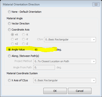

We are also aware of the material angle issue. Under Modify/Update Elements/Material angle then you should see the form below where you can pick a fixed angle instead of having Femap calculate it. I believe that will allow you to get the material oriented properly.
RE: Orthotropic Materials in Nastran Plane Strain Analysis - CPLSTN4
Good to know jbrackin. The only issue with your proposed solution is that the material angle needs to vary for each element; I want them aligned radially with a cylindrical system at the model's center. It would be prohibitively time consuming to manually calculate and assign an angle to each element...

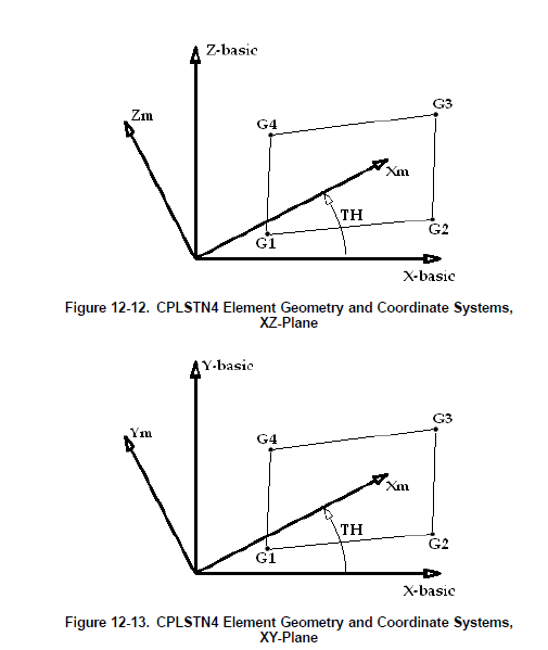

See the picture below from the QRG, the elem cord system is the basic system, so all elements should have the same rotation angle.You are rotating from the basic x axis.
Yes I know the elemental CSys is the basic system. That means that each element will need a different rotation angle to have their x-axis aligned with the radial direction of a cylindrical CSys though. Basically the theta coordinate of each element centroid is the required rotation angle. The only way all elements would have the same rotation angle is if they lie on the same radial vector.
