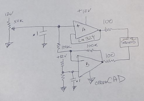

I'm looking for a power control circuit (supply) to drive a -8mA to +8mA electro-hydraulic servo. Previously, I've used a power supply set to limit current to 8mA, with a reversing switch to reverse polarity, but this seems so Flintstones. I've been looking for a way to have a single dial analog control to sweep from -8 to 0 to +8mA but having no luck.
The biggest problem so far seems to be the 1000 Ohms resistance of the servo. I tried using a signal conditioner configured to 0-20 mA, controlled to 8mA, and connected to the servo to in reverse polarity give -8mA, then use another signal conditioner configured to 0-20 mA and controlled in the 0-16 mA range via a pot and connected in straight polarity, with the thought that the 2nd supply would cancel out the 1st as I swept its control from 0 to 8 mA, thereby creating a -8 to 0 mA control, then as I swept it further to 16 mA, would get net 8 mA in the + direction. Turns out they require an output resistance <600 ohms, so that didn't work. The 2nd unit won't drive more than 15 mA through 1000 ohms, and when I paralleled them together (with a dummy 1K ohm load), neither would produce more than half the current they had when connected alone.

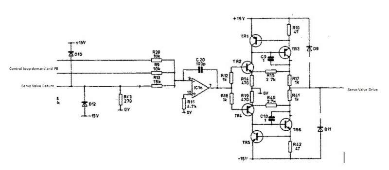

The classic (in every sense of the word) drive circuit for these things is this:
You just need to watch the heat developed by TR3, TR6, R16 and R42.

That looks scary. I hesitate to post this because all the requirements are not known. This is simple and could be done with a single 9V battery. Two op amps are still available in the package for a dither oscillator and input buffer/level changer. One driver goes positive and the other goes negative providing almost full supply voltage to the valve coil. This outputs a variable voltage. Current is a function of voltage and resistance. The two resistors on the positive input of B are both 100K to set the reference at half the supply.

Thanks for the reply. No, they haven't been abandoned, still in frequent use in Aerospace applications, as well as others. I will save your 2nd post and build that circuit as a back-up plan if the item ScottyUK referenced doesn't work. Plus, it's simplicity makes it seem very flexible in application, and perhaps a great reliability factor. The unusual aspect of this particular servo is the +/- 8mA. Most I've dealt with use 0-10mA, 0-100mA, or something similar. But given that this application is a steering function, it makes sense to have the center = 0mA.

Thanks for the reply. That circuit is a bit too complicated for my patience level, but thanks for posting.
