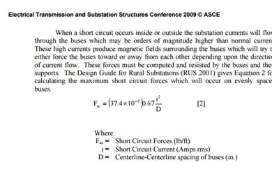

Exactly, thermal forces. There's probably an analogy to the short circuit force that is checked in substation bus (electrical bus, not automotive bus) structures.
RE: Structural Effects of a Lightning Strike
Thank you @Lomarandil,that sounds pretty close. I found an equation for the short circuit force in substation bus structures and will apply it to approximate.
