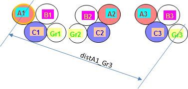

The loop reactance of shield+sheath and 3 grounding cables is:
X=2*w/10^4*ln(2*av.dist/shield dia)*length[km] w=2*pi*60
av.dist=(dist.A1_Gr2*dist.A 1_Gr3*dist.A1_Gr3)(1/3)=208 mm [measured on sketch- approx.]
X=0.2924 ohm
In this case Zsh=sqrt(0.149^2+0.2924^2)= 0.3277 ohm
Rgr=0.118 ohm [20 oC,skin effect, 3 conductors parallel]
Zgr=sqrt(0.118^2+0.2924^2)=0.3153 ohm.

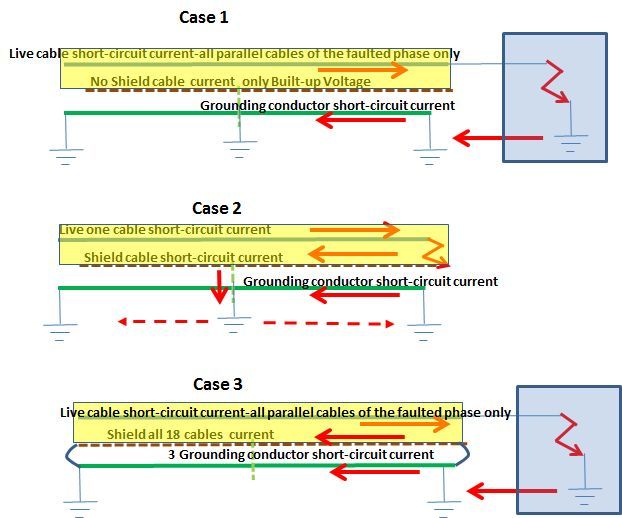

RE: Sheath Standing Voltage at Fault Condition of HV 69kV cu / XLPE Cable
I am sorry, leur 2011.In my opinion, you have to decide, at first, what case of fault you want to study:
Case 1.Conductor phase-to-ground fault cable outside. All shields and sheaths grounded in the middle only. The short-circuit current returns through grounding wires and earth.
Case 2.Conductor phase-to-ground fault inside one cable. Short-circuit current returns to source through this cable shield also.
Case 3.Conductor phase-to-ground fault cable outside. Cable shields grounded both sides.
Case 4. Other possible case.
I don't know if I understand correctly what warross want to emphasize when he cited that "An I2R drop from a voltage divider circuit is entirely different" for a single phase to ground fault where the current is returning through the ground conductor results in a large I2R drop in the ground conductors.
- Maybe, because the conductor currents tend to induce currents in parallel metallic paths – including the cable sheath?
- Allowing these sheath currents to flow generates losses that can reduce ampacity 30-40%
7anoter4, the Case 1 and Case 2 are more applicable to our cable configuration. However, could you please explain the difference of fault outside and inside the cable;
- Case 1. Conductor phase-to-ground fault cable outside
- Case 2. Conductor phase-to-ground fault inside one cable
Case 1.
The short circuit point is located in the supplied equipment-or installation.
"the fault external to the cable".
The short-circuit current flows in all 3 parallel live cables of the faulted phase.
Shields grounded at middle distance only.
No current flows in the shields.
The short-circuit current flows in all 3 parallel grounding cables.
Case 2.
when one cable- of three per phase- insulation breaks down in one point and the sheath or shield will be grounded in one more point-that means inside the cable.
The short-circuit current flows in a part of the shield up to the grounding connection point- only in the faulted cable.
Case 3.
Shields grounded at both ends.
The return short-circuit current flows through all 18 shields in parallel with the 3 grounding conductors.
Correction: case 3 :
The return short-circuit current flows through all 9 copper tape shields and 9 lead sheaths in parallel with the 3 grounding conductors.

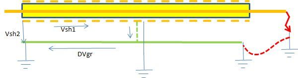

In my opinion, it is not a permissible limit of the voltage built-up in short-circuit conditions. You have to calculate the voltage drop and to choose the suitable SVL in order to protect the HDPE sheath from breakdown. See for instance:
http://www.akpowersolutions.com/Media/Products/AKP...
I think there is some confusion. My understanding is that the cable sheaths are grounded at the both ends but are open in the middle, connected to sheath voltage limiters (SVLs). So, as long as the induced voltage is below the SVL flashover value, there will be no sheath current.
During a Ø-grd fault, there will be current in only the faulted phase, the earth, and the ground continuity conductors. The level of current in the phase is not 1/3 of the maximum design current, but is dependent on the source and cable positive- and zero-sequence impedance. There will be voltage induced in the shield from the phase current. There will also be a ground potential rise at the mid-point because of currents in the earth and ground continuity conductors. The total voltage between the shield and ground at the middle depends on both the shield induced voltage and the ground potential rise. Calculation will be complex. Perhaps a program such as SEL MALZ and SPLITS could be used. See http://www.sestech.com/Products/SoftModule/Splits....

But I want to find out when you mentioned that during phase to ground fault, e.g. single conductor to ground fault (trefoil formation), the level of current in the phase is not 1/3 of the maximum design current (40kA), but is dependent on the source and cable positive- and zero-sequence impedance.
In my understanding, during phase to ground fault, each cable within the phase (say phase A) of trefoil formation, the current through each cable will be 40kA/3, assuming equal impedance due to the source is a 3 winding auto XFR, the tertiary winding will act as balancer for short circuit current flowing back to the source.

In a phase-to-ground fault with a source at only one end of the cable, all of the current will flow in the faulted phase. No current will flow in the unfaulted phases.
