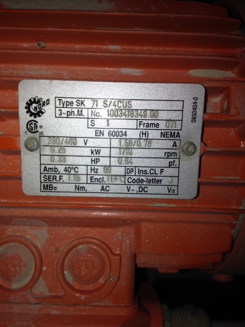

I have a peristaltic pump that when I increment down by one, the motor reverses itself. Every increment down it does the same thing. Also it will not increment up, so don't know if it is the motor, the Lenze frequency inverter, or the programing on the touchscreen or plc. It has never done this before.

what type of motor do you have?
you will have to give much more information about your system
we are not mind readers here
RE: Motor goes backward once it increments down in touchscreen
Is this all info you need Lukin1977?
What is the ENTIRE setup like? Give us the physical chain of hardware please.

itsmoked.. This is a peristaltic pump, pumping liquid to our batch. At this time it we are not even pumping anything. Have taken the hose out just running the motor. It reverses and goes forward after every speed increment down.
waross,... I too think it is a programming issue because you cannot increment up as well, just down. We have had this machine for more that 10 years and it just started doing this.
we have 3 pumps on the system to run three different ingredients if needed, but our process right now only requires two. So we have taken pump 1 offline, I am going to replace
the frequency inverter to take this variable out of the loop. Lets see what happens.
