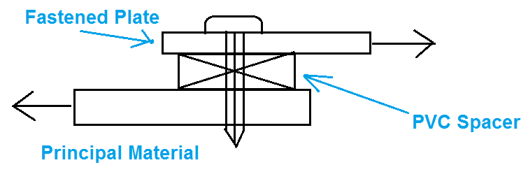

So here's a picture of the scenario. The space between the principal material and the fastened plate is one inch. Won't the fastener be subject to bending? Also, most codes I look at doesn't seem to show any criteria or consideration for bending. It's always shear or tension loads. This has been a long time question to me. What are your points of view ?

Irene, If the two surfaces pulling against each other are also touching each other then the loading on the screw is close to perfect shear. The opposing forces are in line with each other, or close to it. There is little force pulling the screw thread out of the tapped hole. By separating the two loads you create a larger moment effect causing a much greater twisting action on the screw, thus pulling the thread out of the tapped hole. Bottom line - keep your opposing forces either in line with each other or balanced by some other means.

I'd say if the clamping provided by the fastener is sufficient to keep the plates and spacer from sliding, and the two plates don't bend significantly then the fastener will see no bending.

Does the spacer have to be PVC? The ideal way for this joint to work would be for you to clamp the screw down hard enough that everything would be held by friction force. In this scenario, the screw sees only tension. I would expect the PVC to creep and loosen the joint.

I suspect you're showing us a small detail of a larger installation, and a larger view would show us more. How large are the loads ? how stiff the PVC block ? could it react the bending and then the fastener only feels the shear ? I hope there's a nut somewhere (hopefully not on my side of the screen) and you're not pushing shear over a threaded shaft ?

Joints very often are subjected to offset loads and in the diagram you've posted its looks to me that the bending would be negilable compared to the shear but we would need more information and dimensions within the joint in question.
Now if you preload any joint sufficiently to withstand an offset external tensile load then the joint behaves pretty much as described by others, in that the compressed members relieve some of there compression which exists between the compressed faces but in doing so the bolt also has an increase in tensile stress although this increase is usually small.
The reason the bolt stress increase is small, is due to the fact that the clamped faces usually exhibit a stiffness of 4 or 5 times that of the bolt and therefore dissipate the majority of the external force.
