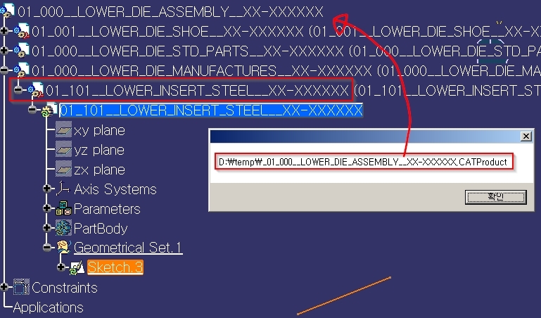

I'm trying to make some macro.
But I didn't solve to get a file name in Sketch.
ALSO I know how to get a Catia Name(Part Number), a Instance Name and an object name in Sketch.
But I don't really have no idea to get a File name in Sketch.
Can somebody help me or give me some tips?

Hello, lardman. Thanks for your reply.
I meant, when I am in "Sketcher" Mode and select an element(Point2D, Line2D, etc..),
how can I get a File name? Not Catia name(Part Number) and Catia instance name.
Here is my script which I found on Google and I modified a little bit.
Of course, I know the 'FullName' method can get a full path of the part when I select only 'Product'.
But I want to get a full path or file name only when I am in "Sketcher" mode.
Could you help me solve this point?

Hello, Ferdo. Thanks for your script.
Your script can find the path in Catia tree..
I meant I want to find a path of a File in 'Sketcher' mode.. ex) "C:\Users\Desktop\Part1.CATPart"
Not "Product.1\Part.1\Geometrical Set.1\Sketch.1\Point.1"
I know only to use 'FullName' method.
But this can't work in "Sketcher" mode. And I must select a "Product".
Do you have some ideas? Please, be my HERO :)
I just tried to use below script. But I didn't get a result what I want.
Because I have a Product that has included a Part.
I have to know "01_101__Lower Insert Steel"'s file name, not a Catia name, when I'm in "Sketcher" Mode.

RE: How can I get a File Name in Sketch?
Interesting...if you will put the whole code in a CATScript will do the job, no mater what you will select and where you are active (Sketcher or what ever...).
Look more carefully at the code and follow his workflow, when you do the selection is "AnyObject" , then you will find the name of the parent of the selection... there are lines there which are not useful for your purpose (just to let you know it can be done also in different ways).
For me is working fine.

Hey, FERDO
Your script solved my problem!
You are my saviour!! You saved me!!!
