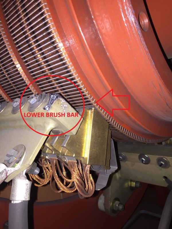

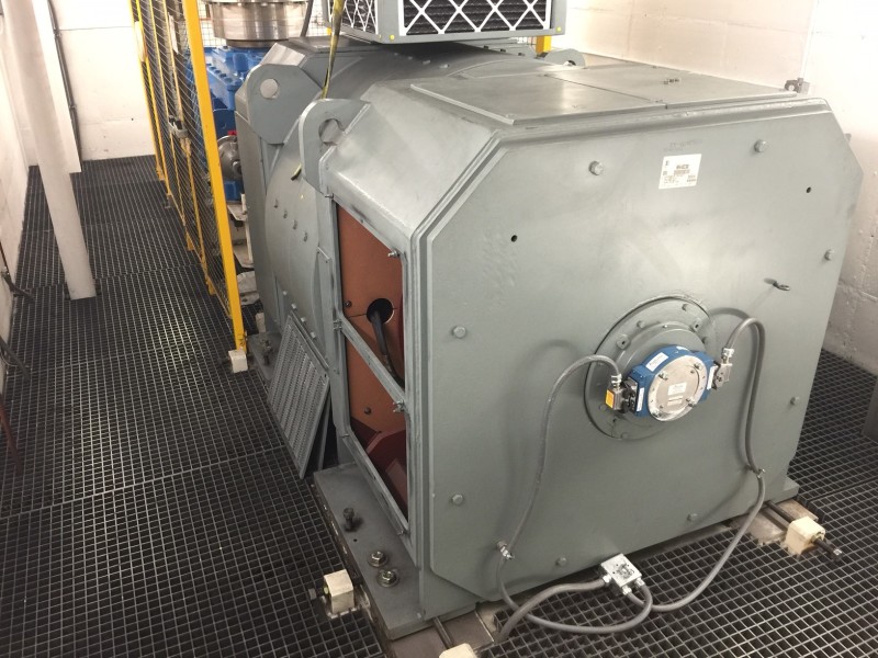

This is my first post here in regards to some motor/drive issues that we experienced yesterday. The motor is a GE #5CD695WA802C800, 1500 HP, 600/942 RPM, 630V ARMATURE, 1865 AMPS, SHUNT WOUND.

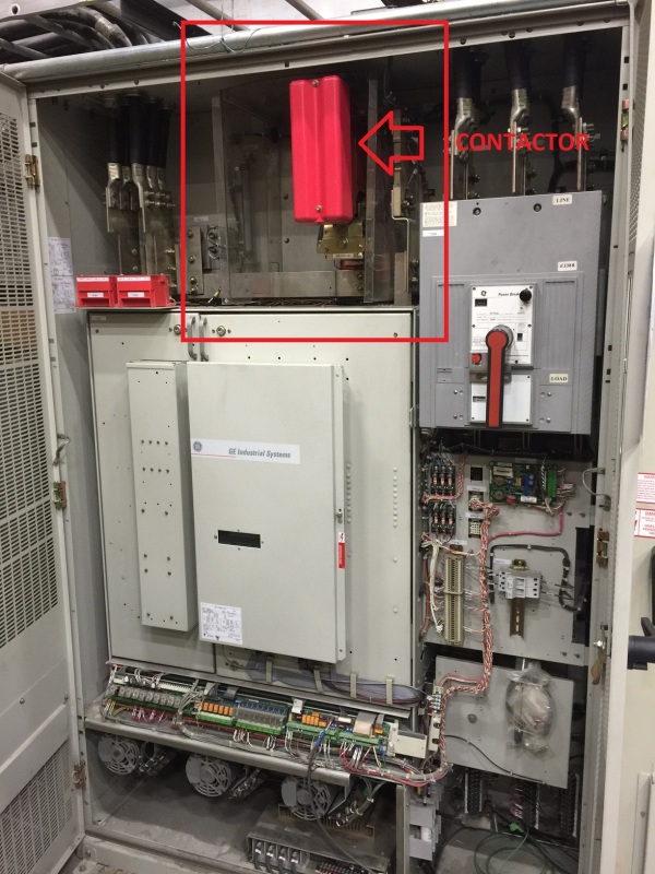

-The first failure we experienced was in the GE drive cabinet, where the drive faulted (assuming self-protection) and the 2400A contactor, which caused a nice loud bang and an arc flash which blew the plastic covers off surrounding the contactor. [This happened as the system/motor was slowing down to a low speed.] We were not able to capture the fault codes from the drive at the time because of someone prematurely disconnecting the drive logic power. Initially, we speculated that maybe the contactor "chattered" causing the arc flash, or simply, the field on the contactor coil has weakened and caused it to behave erratically. I proposed that there may be a hardware issue with the drive itself causing the digital output controlling the contactor to fail, the drive opened the contactor as a means of self-protection, or a few other possibilities. Regardless, they wanted to replace the contactor - so they did.
-We were able to retrieve some logs off our computer monitoring system later, indicating that the armature current was abnormally high when the failure occurred. This leads me to believe again, the drive is protecting itself and opening the contactor due to the excessive armature current. We removed the side panels on the motor and the commutator looked ok and the brushes seem to be well within tolerance. There are approximated 297 running hours on the motor. Myself being tired of all the speculating, recommended that we have GE come in for an emergency service, inspect the drive, the motor, and even Megger it, however, this suggestion was ignored, and later that evening a crew decided to continue tinkering with the system.
-After they ran the system last night a few times, of course, there was another failure, but not at the contactor. The drive fault code was pretty generic (will follow-up - I don't have it in front of my right now), but whatever happened did some damage to the brush bars in the motor indicating there was a decent arc/flashover last night. See attached picture. [When this failure occurred, it was during onset - increased RPM - acceleration.]
-At this point this morning, I am very upset with how mgmt/engineering has handled this situation, so I blew the whistle, and disabled the device so there is NO chance anyone can start the device, let alone power up the drive.
Now, my questions for this forum are the following:
> In the initial incident, while the motor was slowing down, why would the armature current be so high?
> Is it at all normal for the contactor to violently arc-flash and almost self destruct?
> During the second failure, what would cause such a violent flashover that melted the end of the brush bar?
I am adamant about getting GE in here to evaluate the system, but I personally want to grasp a better understanding of how this systematically failed. Additionally, I am using this incident as a learning tool for myself and to develop some better safety procedures and incident response guidelines.
I sincerely appreciate any information, suggestions, and tips from all in this forum. Please let me know if you have any questions or would like pictures. I have many more pictures I will post somewhere and add the link, since it seems I can only upload one file at time here. Correct me if I am wrong - this is my first time posting here :)

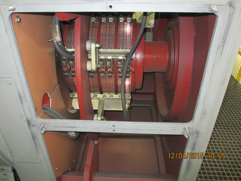

More pictures of the motor commutator:

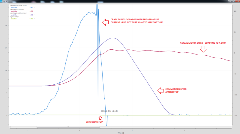

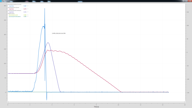

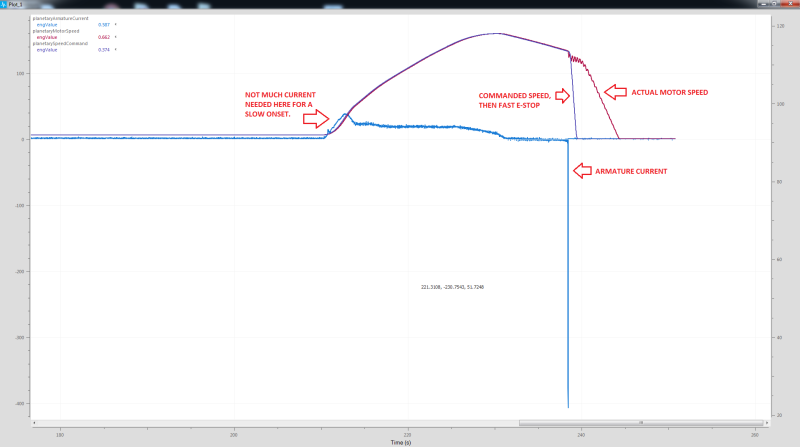

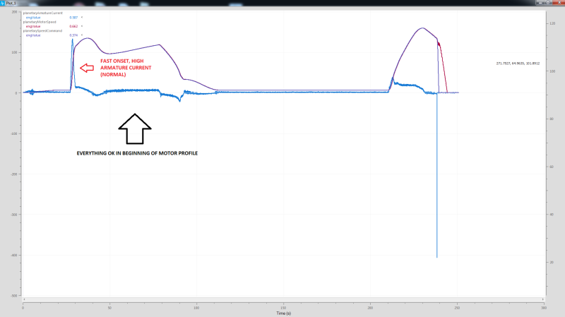

So I have gathered logs from our Fault Log Manager as well as some information from the drive itself.
Here is the 1st run where the drive contactor opened during de-acceleration:(This picture is zoomed/cropped to show detail)
Same run, just zoomed out for a glance at the complete profile. You can see in the beginning it was operating as normal, high onsets, high current, all normal. Then, during the second half of the profile (that is zoomed in above) it is a much slower commanded onset, therefore we do not require as much torque/current from the motor. Regardless, the commanded speed matched the actual speed until about 238 seconds into it (X-axis), current drops, E-Stop, etc ...

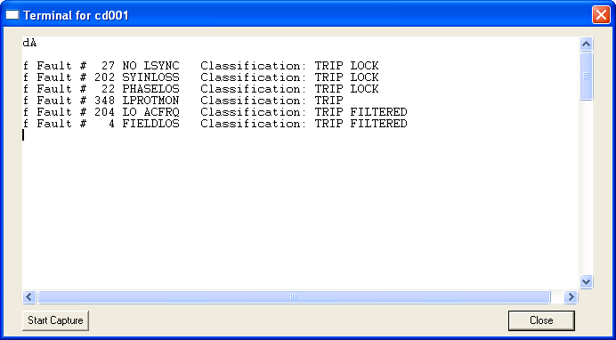

These were the faults that were pulled from the drive:

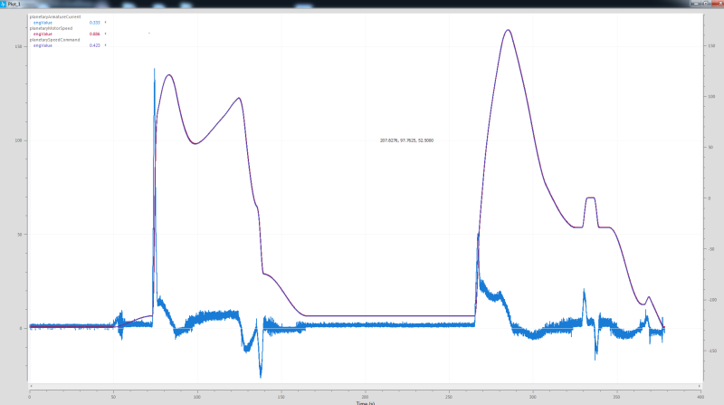

RE: Requesting Advice for DC Motor Flashover / Failure (GE 1500HP)

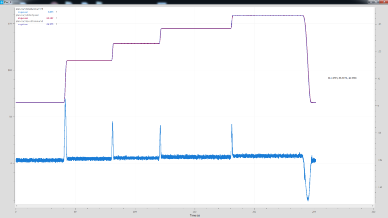

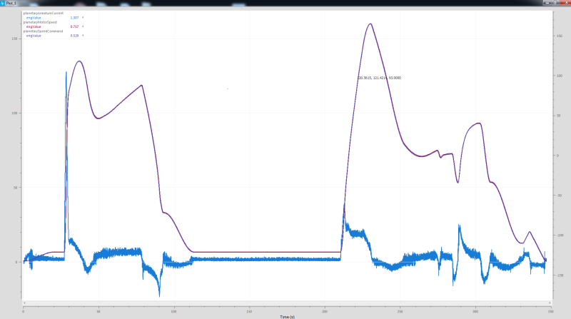

Later that day, after changing the contactor, 3 profiles were successfully run (in a row).
First:
Second:
Third:
The next run caused the large flashover inside the motor (see next post, I have to get the data together) :D

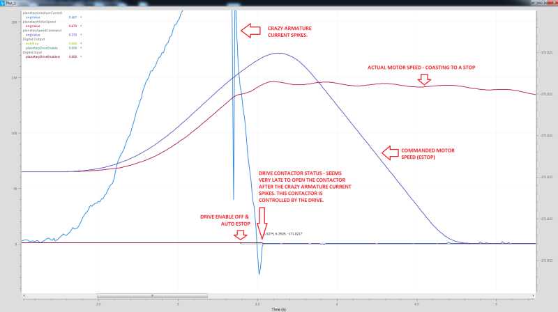

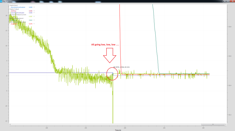

Here is the last run performed which is when the flashover inside the motor was experienced. This first picture is zoomed in to show the ESTOP detail. See next image for complete profile.
Complete Profile - Zoomed out.
Now what I find interesting in this final chart is the fact that AFTER our computer system initiated an ESTOP and set the Drive Enable Status to LOW, the drive did not close the contactor until after the crazy armature current spikes. From the 1st fault, the drive caught itself before our computer system did, and in this fault, our computer system caught the fault, initiated ESTOP and drive kill commands, but the drive did not self protect itself by opening the contactor.
Is it possible the contactor got stuck from the high current?

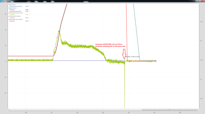

In regards to the chart above showing the time delay between the computer ESTOP/DRV_EN and the actual drive contactor, I found out that somebody modified the contactor by removing one of the 2 springs installed.
Is it possible the delay was a result of the contactor NOT being able to open because a spring is missing!!!??????
This is starting to make more sense to me as now, I will post a log of the first run (before anyone touched the contactor) and it is very clear that the Computer ESTOP/DRV_EN & the actual Drive Contactor (a monitored DI) all went LOW simultaneously.
Middle Zoom so you have an idea of whats going on:
Full Zoom showing all going low:

Are you able to attach those images as i am currently having trouble reading the signal names. Do you have contactor feedback into the drive enable circuit?

-Yes, the contactor feedback is a Digital Input (Interlock) on our computer control software. In the 3rd to last chart posted, it shows that DI going LOW (after) the computer system issued an ESTOP and cut off the drive enable signal. There should not have been ANY delay here and should have went low at exactly the same time as the last two images posted
-The drive settings have not changed and were not tampered with. This system has been in place and in-use (un-tampered) for the past 5 years with a total of almost 300hrs on the Drive/Motor. Validated by a mechanical timer that only records the time when the motor is actually spinning.
-Someone removed one of the two springs on the contactor thinking that it would help in case the contactor became stuck.

The photos posted of the motor commutator are excellent examples of what many
here on the forum usually appreciate. Clear, up close, great lighting, and more so.
Thank yOU for the great pictures!
If there was no commentary posted with the commutator photos, and one was relying
completely upon the pictures only as a means of “guessing” what the motor problem
may have [had] or has, I would submit there’s likely nothing electrically wrong with the motor.
With the internal motor environment being very clean and the commutator wear pattern
(for the most part) showing no obvious sign of "in-operability", I’ll toss out the following observations
based solely on the photographs.
The commutator bars show a slight evidence of edge burning. A factor leading to flashover.
The dark color streaks near the end portions of the commutator indicate possible material drag.
Deposits of copper material from the “edge burning” would likely be the source.
Again, a situation resulting in flashover.
Light brush pressure, or the wrong brush grade could be a cause, yet with such a new piece of
equipment, I’d lean more toward some kind of mechanical vibration as the root culprit.
(A kind of shaking, and rattling of the brushes in their boxes.)
